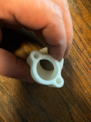

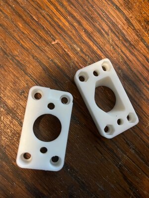

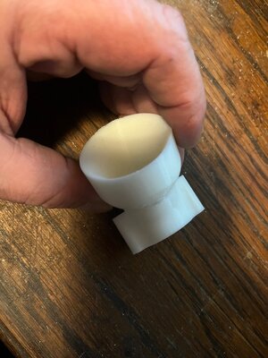

My final solution. Only the intake still need a small work for the attachement.

That’s pretty slick. You get rid of the factory “firewall”. I wonder if you’ll have any hot restart issues because of it.

I'll see if there are any problems. With the original, large carburetor gasket, the carburetor is already somewhat shielded. The inner channel leading from the fan to the carburetor is sealed, and the air filter will no longer be inside the housing but exposed to the air. Therefore, heat buildup shouldn't be much of an issue. But I'll see. Next week, other parts will be ready that I need for assembly, and then the test will begin.

Since some people asked me if I could send them an adapter set, I uploaded the STL files to Cults 3D. This way, anyone can print the parts themselves or have them printed. You will still need: 6 M5 nuts, 6 M5 x 15 screws, 2 M5 x 65 screws, and of course a carburetor and an air filter (40mm).
