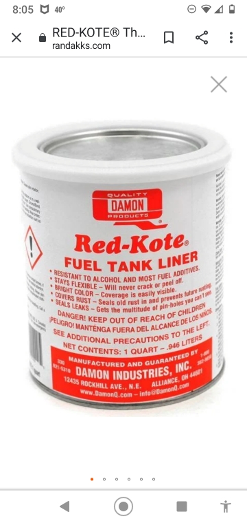

A guy I know used this on an old tractor gas tank. There are many different brands and sizes.

Second on the Red-Kote. Used it on a diesel tractor tank years ago and still no leaks. Don't get it on you or anything you don't want it on. Got some on the jacket I was wearing and I wore out the jacket but not the drips.

I think red kote is what my neighbor used on my generator fuel tank. E free fuel since that happened!
Red kote is the best thing.
