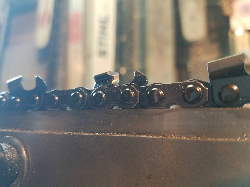

Ok this is my first ever square filed tooth. Lol it is on an old junk chain.
Please be as critical as you are willing.
I think that is how it is supposed to look.
I did 20deg top and 25 deg tilt. Ifor this is any good I may try converting a chain tomorrow.
Need a little more forward lean with your cutter and clean out that gullet
Give 35 top 30 tilt a try.
