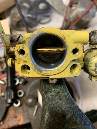

These are on the end of the carb where the air filter bracket goes.
Look for a raised letter in the carb casting, H & L. Other than that, IDK.
That is an odd duck. You could always pull one and insert, say a WD40(or similar such thing) stem/straw and give it a shot and see just where it comes out. If in the middle that's the Hi, if by the throttle plate, that's the Lo.

I think I got it figured out last one is idle and right one run. Thank you for the help. can't believe how easy the saw starts and runs. It does not get into very high RPMs but I expect that from a old saw like this.
