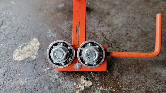

I've already prepared everything, all that's left is to put it together, i.e. drilling, threading and welding 🤠👍

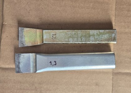

Got these from Stihl many years ago. They work well if you close the rails to tight. The one on top is part #1106 893 9200 | Groove drift, 1.6 mm. The bottom one is part #1110 893 9200 | Groove drift, 1.3 mm. I have found as others have said with using bar rail closers the bars tend to spring back pretty quick. But I was cutting timber professionally at the time. I would maybe get another day. Probably should have just went to .058 gauge from .050.
Sorry it's bold font.
