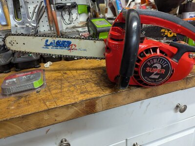

Hello there guys,
I took a picture of the Data Plate Arrrghhhh.
I'll need to take another one of the Saw itself.
Say Wood Doctor ! It absolutely looks like yours. ( Just without the hand guard )
I'll post a picture of the whole thing when I get back home.

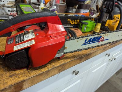

Hi there folks !
The new chain is amazing, thanks to everyone who offered help.

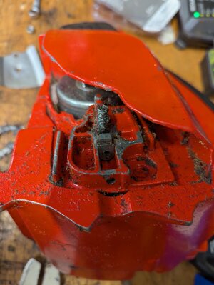

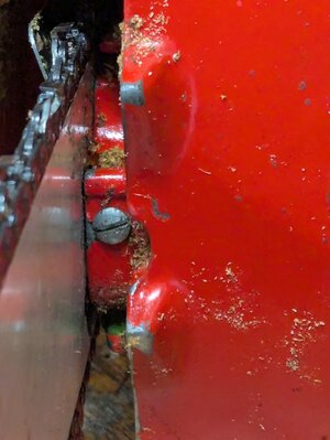

While I disassembled the saw I noticed that the Tension screw was gone !
I can't believe that I used it for so long, putting up with constant loose chain syndrome.
I put in a screw to run the tension pin and discovered that I needed a nut on the other side to hold the screw in place.
It seems to work now. However I was wondering if someone has a part number ? I'm curious to find out what the original part looked like ?PXL_20250525_174411014.jpgPXL_20250525_174411014.jpgPXL_20250525_165458102.jpgPXL_20250525_164330419.jpgPXL_20250525_164323363.jpgPXL_20250525_164315283.jpg

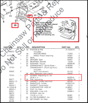

I believe the following is what you are looking for directly from the IPL. Not sure how you are supposed to crimp the end of the screw...that is a new one for me.
Here is the link to the entire IPL on Leon's Chainsaw and Parts website: Leon's Chainsaw and Parts - Homelite Super 2 IPL

Assuming that he has the original adjuster or removes the threads at the at the head of the bolt he is using.
I guess crushing the threads at the head of the bolt would do the same thing too?

Check this out

8 x 32 x 1 is fantastic data ! ( Which is a pretty standard size, phew ! )
Thanks so much for everyones suggestion.
I do have the Adjusting Pin, it can be seen in the 3rd picture from the right.
The good news is the threads are in good shape.
When you "tighten" the screw, it pulls the Pin forward, pushing the bar out, providing the tension.
When you turn it left or loosen, that's when it wants to back out as it pushes the pin towards the body of the saw.
The hole that the screw goes through is so worn, that it doesn't catch the threads anyways.
So I put a captive nut on the inside of the channel pushing against that wall as the pin moves back towards the saw.
A small dot of locktite would probably be the final fix ?
The Crimping reference is really interesting ... I'd LOVE to see how that works

Check this out
A "C" clip with a channel in the screw to retain it .... brilliant !
