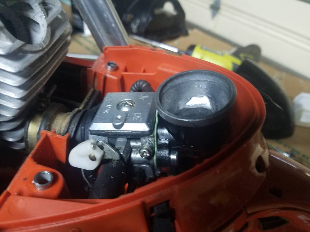

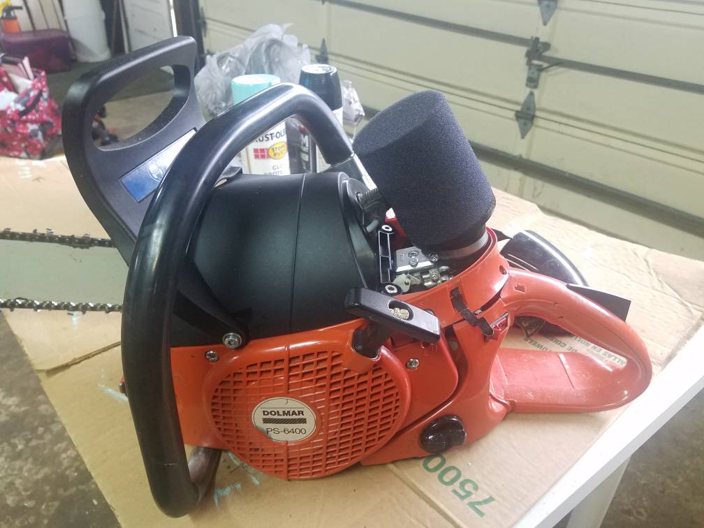

If you check out the videos that Mike did when he ported my saw at the beginning of the thread, the saw is down in power because of the HD filter. I think it's the tight HD elbow not the filter element. It's probably a great set up on a stock saw.
I'm trying the black mesh to see if it flows better. @t4driller made a sweet elbow to run a nice filter
This is the one I made for mine. Seems to flow pretty good. Ran it without the filter and couldn't tell a difference. Not really a setup for work saw though.
