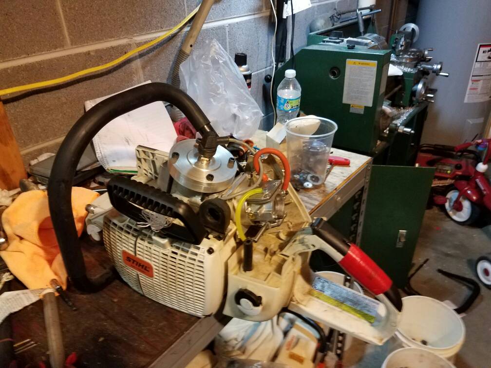

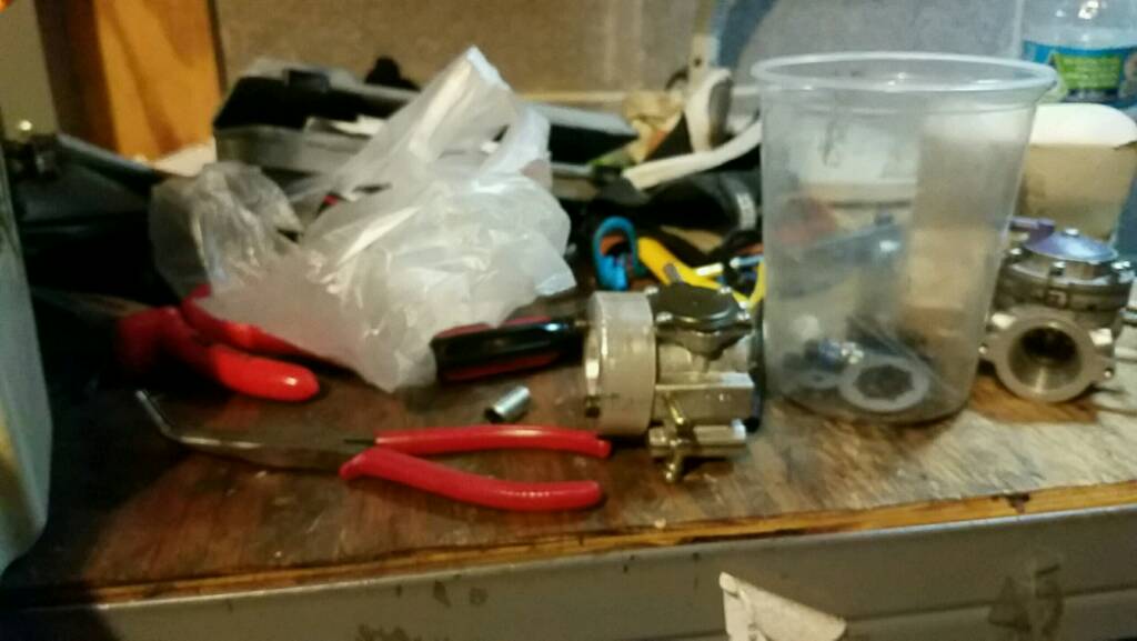

mdavlee Hillbilly grinder Local time 10:44 AM User ID 279 Joined Dec 28, 2015 Messages 14,194 Reaction score 64,635 Location TN Mar 1, 2017 #21 Working on carb plates now. Not sure what to run. HL 360 or 380 would be much easier linkage.

mdavlee Hillbilly grinder Local time 10:44 AM User ID 279 Joined Dec 28, 2015 Messages 14,194 Reaction score 64,635 Location TN Mar 1, 2017 #24 spencerpaving said: Put a super bn on it! Click to expand... Might be a bit big at 44mm
mdavlee Hillbilly grinder Local time 10:44 AM User ID 279 Joined Dec 28, 2015 Messages 14,194 Reaction score 64,635 Location TN Mar 1, 2017 #25 Little more work done. Spacer made for the carb. Plate drilled and tapped. Got to make the hole through the plate for the carb bore and it's on to linkage.

mdavlee Hillbilly grinder Local time 10:44 AM User ID 279 Joined Dec 28, 2015 Messages 14,194 Reaction score 64,635 Location TN Mar 1, 2017 #29 It's alive. Got to do a few more tweaks on it and the linkage.

T.Roller Mastermind Approved! Local time 10:44 AM User ID 1277 Joined May 11, 2016 Messages 15,385 Reaction score 53,458 Location Southeast, TN Mar 1, 2017 #31 mdavlee said: It's alive. Got to do a few more tweaks on it and the linkage. Click to expand... I thought the vise grips worked well lol
mdavlee Hillbilly grinder Local time 10:44 AM User ID 279 Joined Dec 28, 2015 Messages 14,194 Reaction score 64,635 Location TN Mar 1, 2017 #32 T.Roller said: I thought the vise grips worked well lol Click to expand... Maybe for cold start wide open only. It did idle pretty well when I had the vise grips rolled a little.
redoakneck Pinnacle OPE Member Local time 10:44 AM User ID 620 Joined Jan 20, 2016 Messages 878 Reaction score 1,995 Location Ohio326 Mar 1, 2017 #33 Sounds like a dirt bike !!!
mdavlee Hillbilly grinder Local time 10:44 AM User ID 279 Joined Dec 28, 2015 Messages 14,194 Reaction score 64,635 Location TN Mar 1, 2017 #34 redoakneck said: Sounds like a dirt bike !!! Click to expand... Sure does.
redoakneck Pinnacle OPE Member Local time 10:44 AM User ID 620 Joined Jan 20, 2016 Messages 878 Reaction score 1,995 Location Ohio326 Mar 1, 2017 #35 Be cool to put a pipe on that dude??
redoakneck Pinnacle OPE Member Local time 10:44 AM User ID 620 Joined Jan 20, 2016 Messages 878 Reaction score 1,995 Location Ohio326 Mar 1, 2017 #36 Whole lotta shaking going on, hopefully smooth out a bit when dialed in

mdavlee Hillbilly grinder Local time 10:44 AM User ID 279 Joined Dec 28, 2015 Messages 14,194 Reaction score 64,635 Location TN Mar 1, 2017 #38 redoakneck said: Be cool to put a pipe on that dude?? Click to expand... It will. Adam is going to send me the pipe for it. Going to be a fun if I can get it dialed in.
