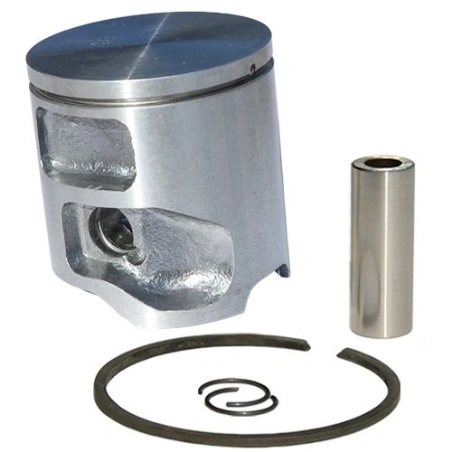

Are there any aftermarket dual ring pistons for this saw?
Its just a great size for milling with the mini mill and a 20” bar for making small lumber, but the lack of a second ring doesn’t work well with heat dissipation.

I haven't seen a dual-ring piston for 555/562, and I think due to the configuration (with the cut-outs for strato) none of the aftermarket companies have attempted to produce a dual-ring piston.

I've never seen a 2 ring piston for this saw. I think it would mess with all the goofy ports and stuff in the cylinder and on the piston

Basically what JJ said. Im not up on what all the cutouts and such are on the piston or cylinder, buth there are alot of them.
rs=w:600,h:600
OIP.CFUN3RiMYBzAnW-u7BtqRwHaHa
Bad pic of the cylinder but P/C both have alot of ports and cutouts that I would have to imagine match up just perfectly. If you look at the piston, you couldn't even fit another ring slot without moving the first one up further. From what I have read. The inside of these saws is like a balancing act. There isn't alot of tolerance to change stuff anywhere
