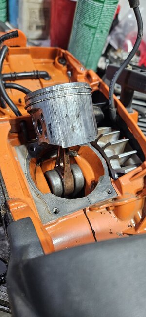

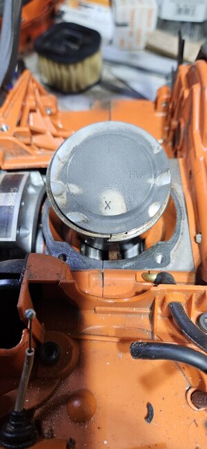

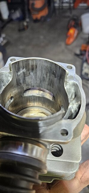

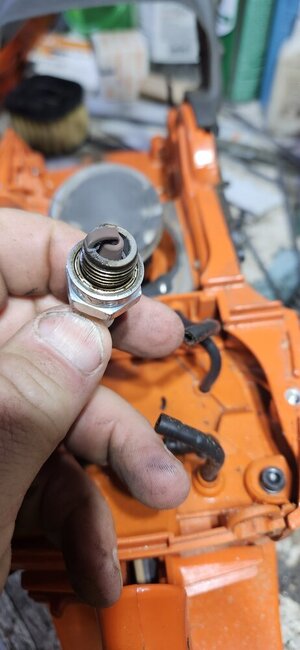

Had a chance to get the top end off this morning. I think plug looks good. Wash is good. No noticeable bearing issues.
I'll clean it up and see if the vibration is still there.
