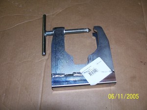

I believe I'm gonna be going the route of dropping in the new crank. I'll probably be posting a wanted ad here soon in the appropriate forum. As far as splitting the case, are there actual specialty tools for it? Also does anyone have the torque specs on everything that gets opened up and a part diagram manual for a 395xp would be great? Does anything need to be greased when dropping it in. Sorry for the million questions, just want to be totally prepared for what I am getting my self into. Thanks.

You will need a crankcase splitter. Many people get by without one, but they are a good tool to have. Go ahead and replace bearings and seals while it is open. I always coat the piston, cylinder, and bearings with some 2 stroke oil before assembly. I like to put Motoseal on the outer edges of the crank seals to make sure they don't leak.

I have vids on my youtube channel for doing a rebuild on a 394, which is similar. The bearings will need to be put in by either a press, or by heating up the case. Though I don't think I have bearing replacement vids for the 394/395 .... I'm pretty sure I show how to do it for other saws....372, 346xp ... so you can see how to do it. The 395 will be fairly easy in that respect.
contact BPLUST here on this forum if you need a part... he likely has it.
You can make case splitters ....or buy one. Up to you. Again, search around in my vids.... lots of info there.

I think this a really low hours saw, there is no need to replace the bearings. If you're careful you could even save the seals but you'll need to use a pick to get the seal over the lip in the crank when assembling. Best bet would be to use a husky type splitter that leaves the bearings in the case. Then you just heat the inner race a little with heat gun for reassemble.

YEP, those are ALL the tools needed ... wow.

heat is your friend if you don't have a press heat the case half up with a heat gun the crank and bearings with slide right out of case
you'll need a bearing separator puller to get bearings off crank but you 'll be getting new bearings and crank anyway install in reverse order
