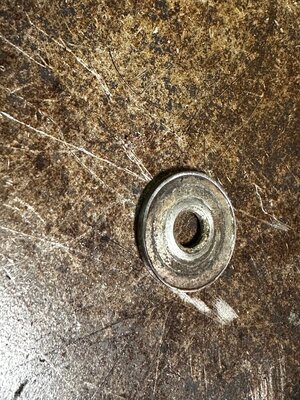

Might have a nos replacement…:p
Yup, have one…
