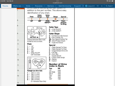

Anyone have a 33RS or RSL to do a side by side with an RSK to see what the chassis and raker difference is?
Jusgunn3
1:51 AM
28560
Feb 21, 2024
743
2,542
California
