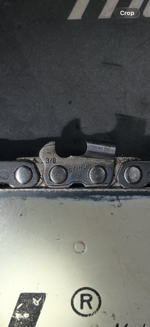

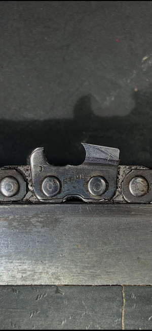

I was able to take some pictures of the differences between RS/RM (Previously RSC or RMC) with the “Comfort” anti/vibe feature that is now standard, and RSK which is a legacy chain with nothing fancy.
Pictured first is RM and you can clearly see the area under the rear rivet where it will rock-back once it engages wood.IMG_2991.png
Next is RSK, and aside from a bur from logging wear and tear, you can see how it makes full contact across the whole tooth.
Also note the raker difference. I hope this helps coincide with my description previously about the difference.
