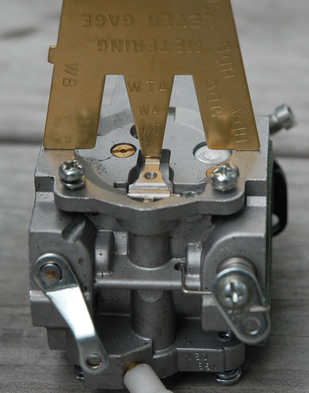

Take the metering diaphragm cover off and eyeball where the top of the inlet needle lever is sitting. I believe in the HDA carbs it is usually set flush with the edge of the body of the carb.

I was having issues with the 120 in mine. Believe I ended up setting it just a smidget below flush. Ran fine after that.

Thanks a lot guy's. The metering needle was set to high, I brought it down so it was flush with the top of the carb. Now the saw will run but it takes a while for it to idle down. First thought was air leak, but i have a spare carb and the saw run's great with that one. Still when i start to unscrew the top of the carb, gas seeps out. I played with the needle quite a bit and still the same problem. I took the needle out and tried cleaning it with carb cleaned but its almost like it sticking a little bit. Does anybody know if they make complete carb kits for the 87? Is it the same as 120, 144? Thanks again
