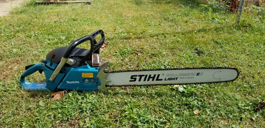

Did you try putting the chain on both the bar and rim before installing it on the clutch/saw as one unit? I've managed a few real tight ones, they are a puzzle.On a 7900, with Husky bar, 92dl will work with a 7 pin, 93 with an 8, 94 with a 9.
Here is 92dl with an 8. Not long enough
View attachment 200613 View attachment 200614
I did not. Figured if we were spinning up chains for specific saws that they may as well go on easily. But I'm sure that'll happen on a few of them given the different drive link counts and using stihl bars from different manufacturers. Like on Cannons that already have a longer slotDid you try putting the chain on both the bar and rim before installing it on the clutch/saw as one unit? I've managed a few real tight ones, they are a puzzle.

Stihl bar 91dl with spacer and 8 pin fit just fine! Please change my chain to 91dl!I don't have a stihl 28
