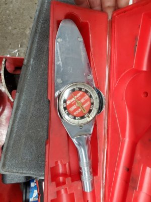

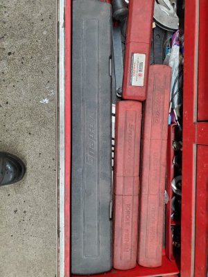

Case bearing preload is measured by rolling torque.
You need to measure rolling torque on the pinion. Then measure it with the carrier in place and keep adjusting until that's in spec and also backlash.
