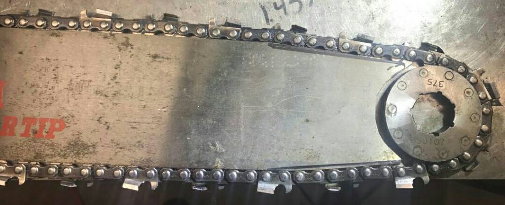

Like the title says, can you run a 10 pin 3/8" sprocket with a standard large mount bar? Or will the chain want to run off the rails?
What about an 11?

Lee had a 10 pin on his 395 with a stock bar. He had 73dl instead of 72dl chain

A 9 needs the chain pretty tight if you bump the edge of the log on a changeover. 10 is quite a bit bigger than the tail. I used a big wide 24" Stihl es bar and cut it down to accept a 72dl chain. I can get you pictures tomorrow

Anything is possible. But why not mod the bar so you don't have to worry about ruining a fancy chain after you throw it?

Did you convert a 20” to 16”?

I've got a bar I modified to be able to run a large drive sprocket like a 10 pin .Open slotted about 20" long fits a large mount McCulloch,large Homelite or large Stihl .Let me just say none of them has enough ballz to pull a 10 pin .404 because I've tried .Thought it was a great idea at the time ,wrong .
