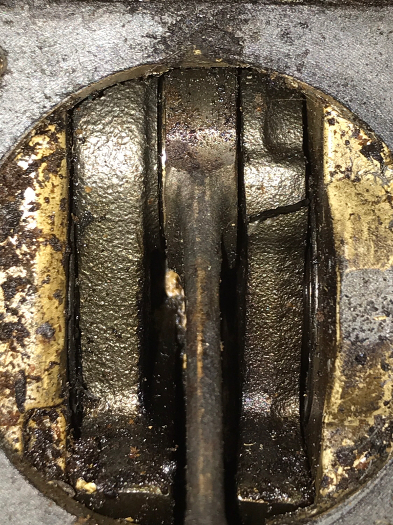

I thought the piston would make it but the one side is just too wallered out. It allows .010" vertical play when there should be none. 20181101_165523.jpg
I have a near new one on hand for it Clint, so don't worry about it.
The case is back together and on to the next step... the degree wheel.
