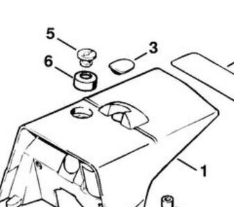

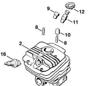

This is why all the larger CC engine sizes had a deco valve to assist in starting. I looked at the parts list for the 036 and the first cylinder for it did not have a deco valve, but it no longer available, and the only one shown now has a threaded hole for a deco valve, as well as a plug to use if the deco valve is not desired. If your shroud has a black plug in front of the spark plug, ref 3 in the second picture, take the shroud off and see if there is a plug, ref 9 in the first pic, and if so you can put a deco valve, ref 11, in. Not too expensive and won't require cylinder removal. A thicker gasket under the cylinder will lower compression and make starting easier, with some loss in power, but that would require a tear-down.

First of all thanks to all who have replied to my thread. Unfortunate my saw does not have the plug for a decom valve. I totally agree with you that age becomes a factor because birthdays have caught up with me also. I don't think that is the problem though because even with it on the ground and my foot in the handle to hold it it will sometimes jerk the cord out of my hand. I no longer am cutting firewood and am now buying it already split. I do however use it on occasions for cleaning up downed trees that fall across my lane. I have several other saws that I can use so purchasing a battery powered one would be my last resort.
