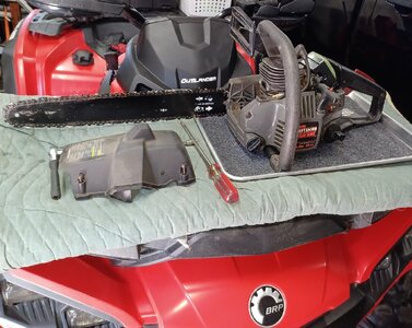

Thanks for the replies . I'm asking because this old gifted Craftsman was was wound with chute cord and I'd like to have the right stuff on it .

Go to searspartsdirect.com . Insert your model number in the search box, numbers only, no dot after the first 3 digits.
That should bring up the IPL and give you a part number for the cord.
Google search for the part number and see what comes up.
Also search ebay, you may find a listing that says something like "9/64 starter cord, will replace part number xxxxxxx"

Thanks , I think that little foil tag holding the P/N is long gone though.
I'll check after work....

That looks like a Poulan-built (model 917.xxxxx) saw. #4 cord ( 1/8 inch, 3mm) should work.
