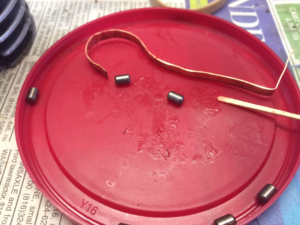

Made a holder out of a strip of copper sheet.
Used it to stick about half the rollers in place. Slid it off to the side and used a wide rubber band (cut) held with a small surgeon's clamp.
Loaded the remaining rollers. Slide the rod over the rollers pushing the rubber band aside with the rod big end.
Carefully turn crank to BDC and lock it there.
