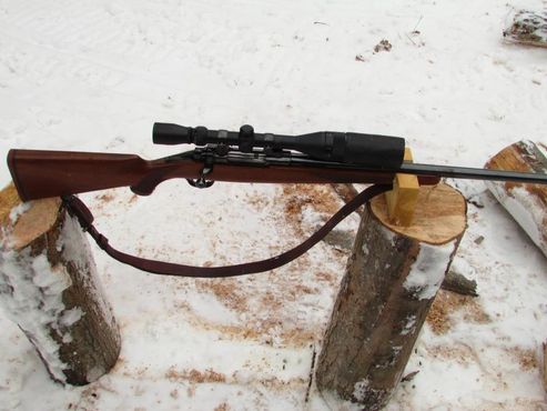

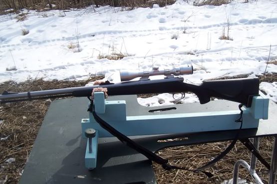

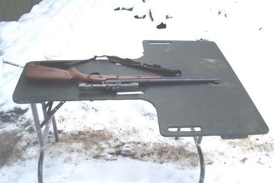

When I switched from real black I went with clean shot. Loved that stuff burnt clean and wasn't hard to clean up after wards.
Never used prydex heard to many horror storys abouthe stuff like in just day.
So when clean shot got sued for makeing pellets when it had been patneted by the comany that still today makes pellets I went with T 7 Great powder shoots well and has lots of ump at 150 yards.
Never had the crud ring every one in the late 1990's and early 2000's were whineing about.
I shot the stuff in my T/C Hawkins, a T/C plains rifle and A 50 cal Remington 700 and 54 cal Remington 700 inline.
I have experminted with the stuff and accrury drops off after 2 shots enough I just swab between shots at the range and every 2 shots if I need more when hunting.
