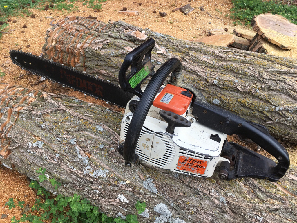

011/012 carb throttle cable question.
There are SIX holes in the throttle shaft belcrank. Which one does the cable hook to?
I tried the second from front and the throttle was held open at rest.
I tried the third and I don’t get WOT pulling the trigger.

67L36Driver
3:49 PM
596
9,400
39,363
Raised from the dead. 011 evilbay carcass for a crankcase assembly plus all the gingerbread and top end from an 012.
The original 012 was roached from moisture in the crankcase. [emoji13]
Pulls the 3/8LP x 18” like a big boy. [emoji106]
