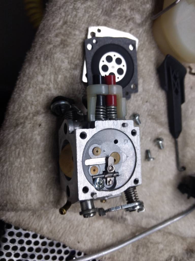

I've used .35mm for the auxiliary jet on a Husky 365. The guy was over the moon about the increase in torque. He couldn't be bothered to purchase a BB kit to bump the displacement.
If you did the mods for the 6401 and then later put the larger 79 or 84cc jug on it, then you could open the auxiliary up to .40mm.

Thanks for the info.
Picked this one up a while back, stripped down to shortblock to clean and inspect.
Need to fuel it, run it.... and of course get a 7910 kit for it!
Will be a build off saw for MMWS GTG next year.
