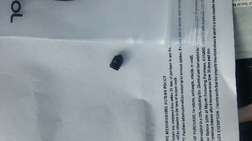

This is the grub screw. Brother in law MS 310 leaking same.. I'll try to get part number. Ed

Find the thread size and one may be found at the local hardware store.

i just nipped the end off a sheetmetal screw on one for a friend, lightly threaded in with a little sealer, no problems a couple years laterp

I built a saw out of NOS parts and that was screw was missing, like the other said I put a grub screw in there .
