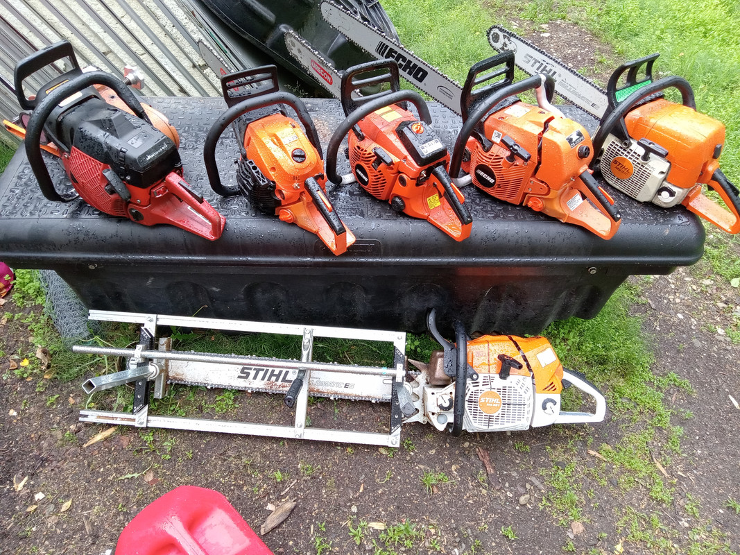

I rebuilt this one and upgraded it to a 390. Here's what it looked like before I started:
It runs today. I do enjoy saving hardware from the landfill, and I did the same as NWWrench. One of my good friends is the new owner. His cousin beat it up before I started.

It was in such ugly shape I almost begged off and threw it away. In addition to what you see here, it had no compression or spark. I found a mud dauber nest inside the pull cord housing. A few small worms crawled out. I removed close to a quarter pound of sludge. I told LOML about it and she said, "Don't show that mess to me. My stomach is turning."

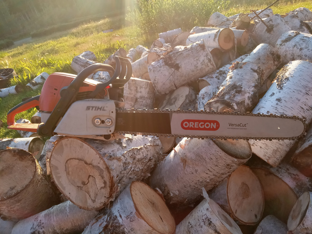

Finally got that EXL chain and versacut 24" bar on the saw. It's a great match and balances the bar perfectly. Helped with some firewood and the neighbor was all grins, bucking the biggest birches he could find.

You saw the Pic in post #5 above. Here's is what it looks like after I upgraded it to a 390:
This is the "after" Pic of the restored saw. It runs today.
