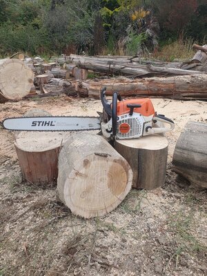

Saws back up and running ! Had a 25 inch bar on it cutting bluegum . Thought the 25 was abit too much and sorta struggled ... so put a 20 on and it didn't back down .
I hear people say they can run 32s on these , is that with soft wood ?
Thanks everybody that helped me get the saw running

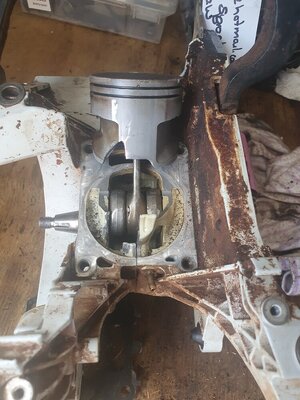

I've got the parts to put it back together , ended up buying another crankcase half , gaskets , piston , bearings and seals .
I've put the case halfs together and there's a gap where the flange is .. do I need to try and get them closer together or will it be ok ?
There will be a gap there because the gasket isn’t shaped to fill it. That’s normal.
Your gap looks wider at the top than the bottom. I might try loosening and retightening the case bolts to see if it will even out. In the end, as long as the gasket is properly sealed and the cylinder mounts flush, you’re good.

Same gap , piston still goes around fine.
Another update : went to put the oil pump , clutch etc on ( ordered an aftermarket clutch kit as it didn't have one ) but when I rotate the drum around it catches on the oil pump.
I've noticed the oil pump doesn't sit flush with the case , looks like the bearing is sticking out to far . When I put the bearings in I made sure it was flush with the inside ... could it of moved out when I tighten up the crankcase ?
Aside from that can anyone help me as to why the drum would hit ? Could I grind the bottom of the drum so it doesn't? Does it matter if the bearing is sticking out?
Also there's a circlip that goes on the crankshaft between the seal and oiler , but I guess because the bearing is sticking out a tad to far it won't go on .
Should I heat up the outside of the case and try tapping the bearing in abit ? I really want to avoid taking the entire saw apart just for 1 bearing :(
Thanks in advance !

You needed to keep the oil pump on to gage the depth of the bearing, I think you figured that out. You have to get that depth correct or everything else will be off.
Those appear to be a non matched set of cases. I guess the PTO side is the original.
You probably have to disassemble. The PTO bearing has a plastic cage that likes to melt. Whenever I knock one out of an old case using heat, the cage always melts. You can disassemble the bearing, which is what I do if it’s a new bearing and it can be reused, but the cage comes out from the inside.
Guess you could try tapping the bearing in from the outside, and then tap the crank back and forth to remove side loading.
I thing a short cut won’t work here. Sorry.
