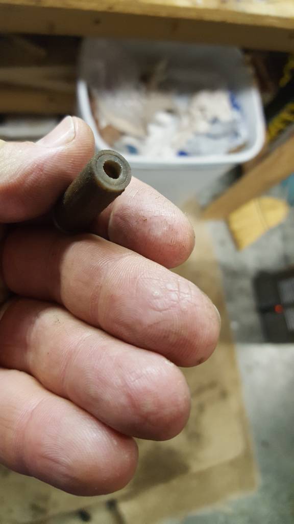

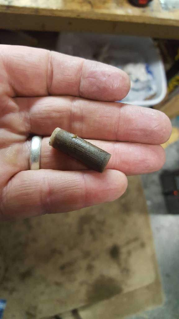

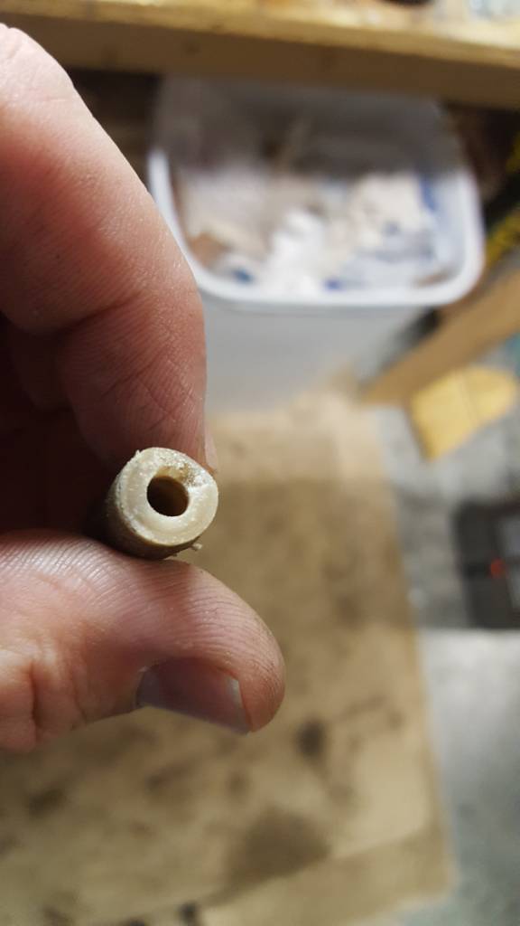

I vowed not to go in the shop last night...but while dewatering the dog I was talking on the phone to a buddy. He said something and I asked "Have you seen my bench lately? ...Neither have I!" I wandered out and spent 10 minutes putting c rap away. I chucked this damn saw on the bench and planned just to knock the B&C off and be done. Well I got a wild hair and said let me look at that fuel pick / filter. I am embarrassed. I had already decided to go through piece by piece as to avoid a shot gun and not know what exactly the issue was. My personality say I want to know what/why/how etc. If the pickup wasn't the issue it'll get another set of new pick up lines. Then we will try another carb. The carb looks new inside and the metering side is set with a Walbro gauge... diaphragm is soft. I had this feeling it was stupid simple... and I hope it was.
The pick up that came out. Note it looked white until I opened it up.
Now I never knew these things come apart so while frustrated... I've learned again. More knowledge to tuck away. New filter in and go again today if I have time.

Also... FWIW...
I ran this saw with an AM from my stash. I also stopped in and purchased a new OEM filter at my "lovely local dealer". $9.00 later I left. I ran this saw with a 91dl bar buried in dry dead red oak. I saw no difference in RPMs and I did not touch the screws between my AM or OEM filter. If anything it was a touch lower idle (100-200 rpm) with AM indicating slightly more flow. Top RPM loaded and unloaded was the same.
I am not saying that all AM filters work.. but for $9.00 for the large black Stihl filters...I'll keep trying AM.

Basher
6:23 AM
552
Jan 16, 2016
1,299
4,254
Canada
Jimmy, the AM internal filter media usually will work for a few days but the gasoline turns a lot of them to a mush like material. I bought a dozen of the big orange filters from Forrester, likely Huztl supplied and they looked great but very quickly caused problems. I pulled the center core out and just run the outer screen, they work good that way in my modified 026`s.
