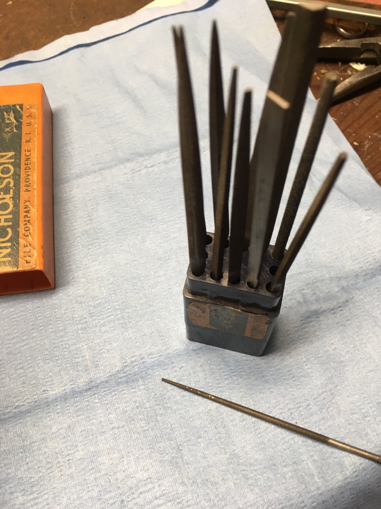

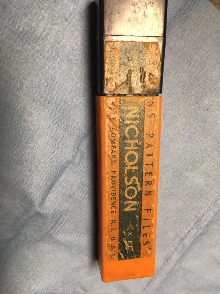

4,254
Canada
Do you know what cut number that is?
My set has 4 cut on the box, the set number is 37404 and are about 5.5 inches long.
Just checked out eBay for a vintage set, the price has gotten real high for these files, Grobet also makes a set much like the Nicholson ones.
