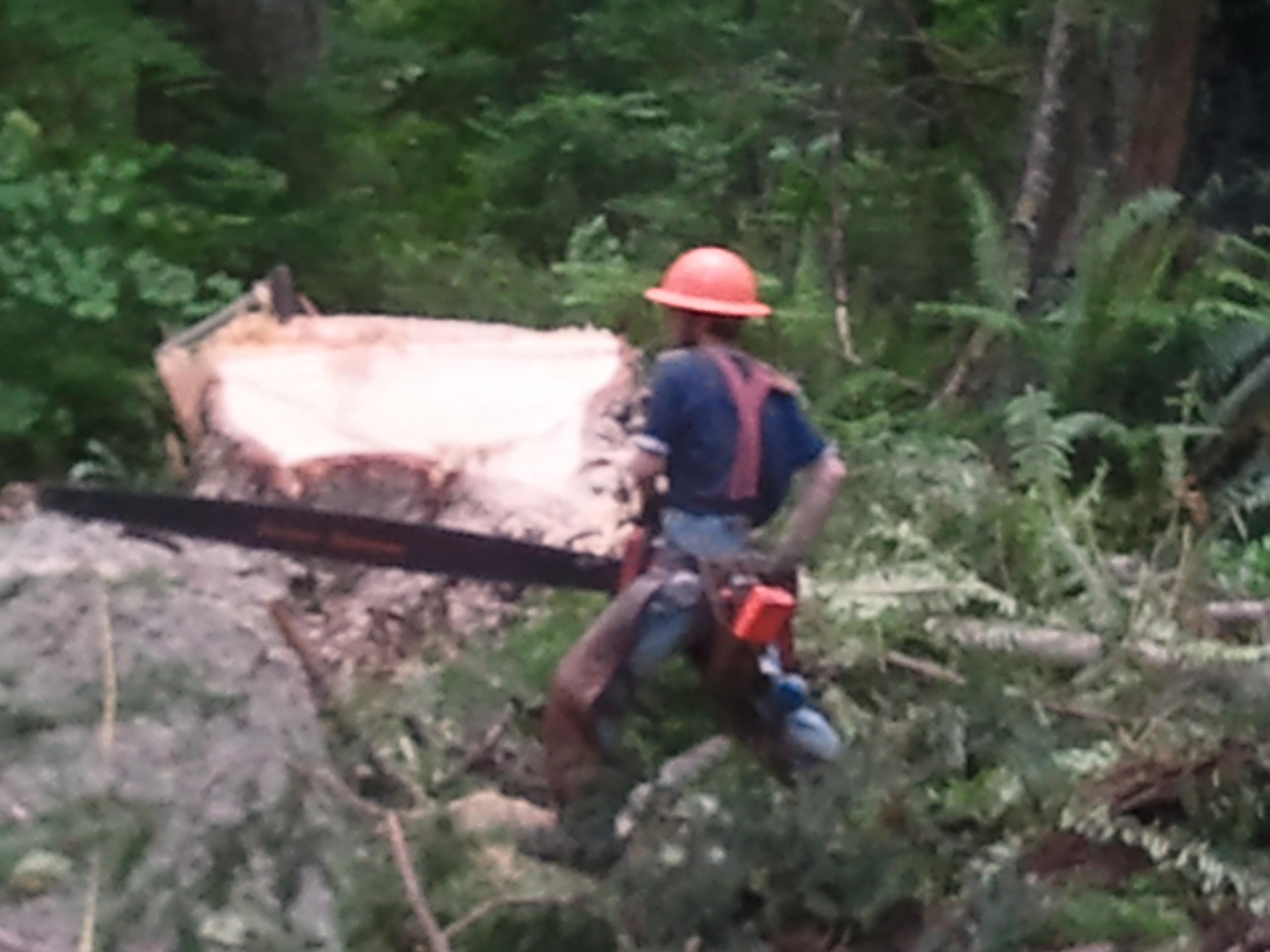

A back killer combo but it’s still amazing they’ll do it.
Pick up your nuts and put them back in your pocket. They might have fallen off doing that.

I honestly think most the new modernized saws are fairly ugly from both Stihl and Husky. I grew up around men running 064 and 066’s and 371 and 2100’s. They are big muscular looking saws with raw exhaust notes, stiff AV, big air filter covers, etc. These new ones, especially the 462, 500i and basically the entire Husky 5 series line seems like going from a 70 Chevelle big block to a Subaru STI. Both fast but one screams class and timeless looks.
I agree, something about this photo, i dunno if its the bar or the angle of the shot or what. But it sure looks like a monolith of power compared to the look of the newer ones..
