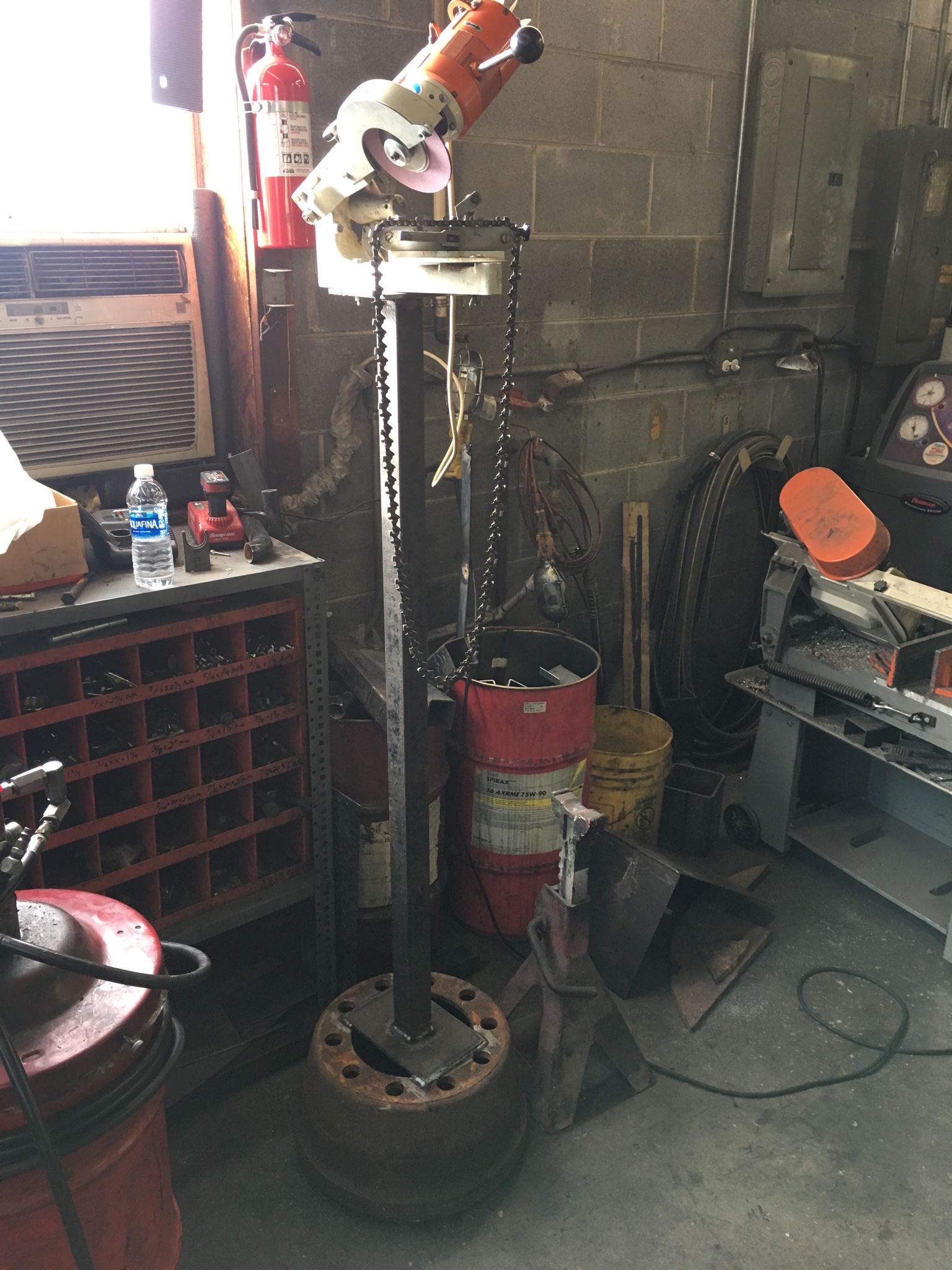

Made me a stand for my HOS. Pretty pleased with the way it turned out. Old girl still works pretty good. I'll definitely be getting a CBN wheel soon.
Very nice, that chain will flat out cut!!!!!!!
How long have you been using that grinder????
I will say, you will love the CBN.....I still use the stone wheels, especially when cleaning out a bad gullet....

I have had it about three years, but haven't used it in about a year because I thought I was gonna have to move and packed a lot of chainsaw stuff up. Things changed and just recently got it back out. I bought it used off AS if I remember correctly. It's not in pristine condition by any means, but it is very well built and parts are still available if needed.

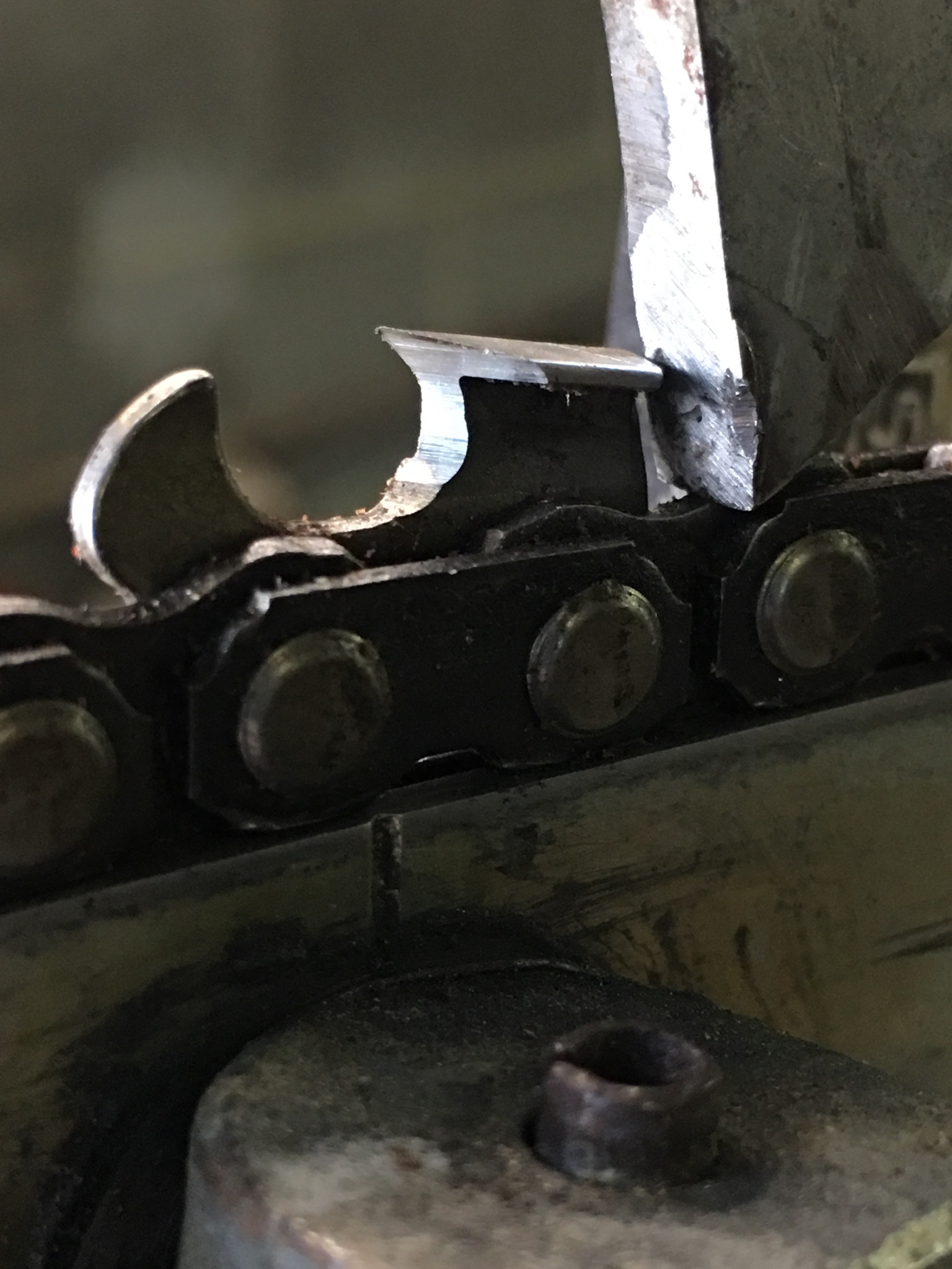

Well guys I am waiting on parts to arrive for my saw rebuilds, so I got some time with the grinder yesterday....I ground my dad's chains which are all the .325 RM semi-chisel.....well after I got his chains done I ground a .325 18" RS full-chisel chain that I acquired....
So anyway I tried something just a little different in this chisel chain......I used my "regular" settings which are 30--55--0(on Stihl chain)..... what I did different was grind a little deeper into the tooth, which creates a little more hook or beak...I don't think it is to aggressive, but I haven't cut with it yet.... I also used the stone wheel on the RS(chisel) chain....I used the 1/8 wheel on all these .325 chains.....
The first 2-pics are the RS chain.....the last 3-pics are RM(semi-chisel) chains.....comments, questions, concerns all very much appreciated LOL!!!!!!
