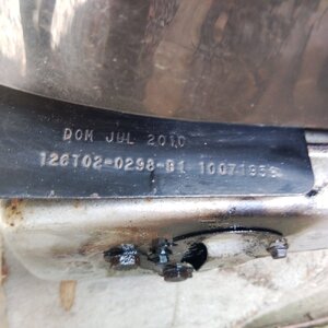

I got this from a buddy that had it on his splitter and he asked me to see if I can fix it so he'd have a spare .
He said it wouldn't start and oils pouring out of the exhaust/muffler .
I did a quick compression test and I'm only getting 50psi which from the little ive read is way to low .
I'm thinking at the least maybe a bad ring ?
Any other ideas what it could be and how to check it out quick without completely tearing it apart ?
Thanks
Ernie
