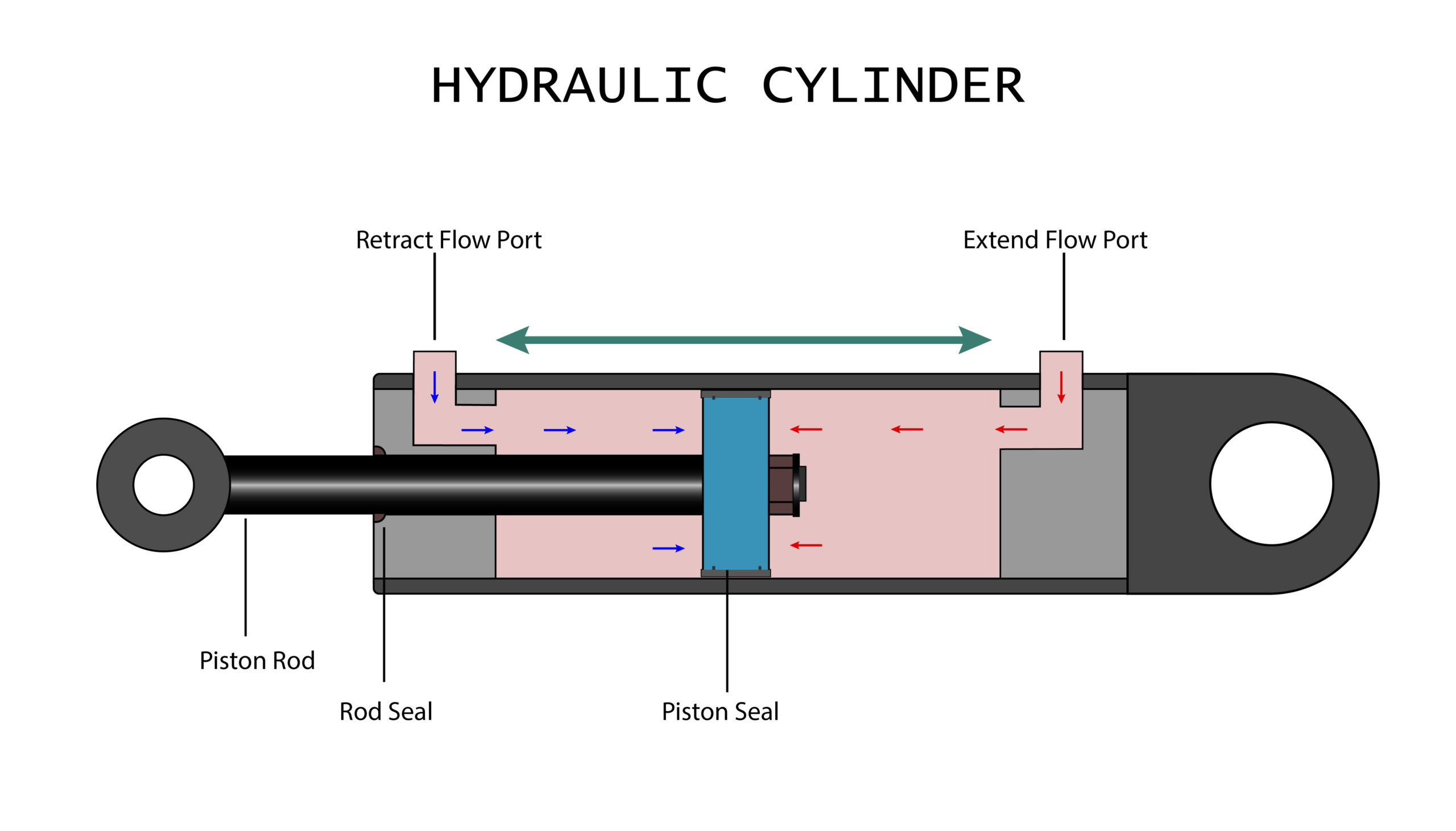

If the piston goes through the seal like that you will end up destroying the seals and the wiper. I just did a quick google search to show you the break down:
Once you break the wiper, which I imagine is hard plastic on these models, then your seals will follow, even if you manage not to originally destroy the seals with those bulges. The metal for the raised spots had to come from somewhere, I doubt the piston rod is completely square and straight.
I have bought a few damaged and destroyed (electric and gas) log splitters over the years and it is never worth the $ to fix a bent piston rod. I just used them as they leaked and then junked them when the leak got too bad. Any leak = less pressure.
I suspect these "all in one" things that use springs for a return do so because they are single acting so there is no seal at the cap end, just the base end. So, if the piston rod is fairly straight, going in and out, and not cocked inside the cylinder, then the seals on the base end should be fine, though any wiper on the cap end will be destroyed, eventually. BUT, it is probably just flexible rubber and not hard plastic.

> Do you think it will lose pressure as the piston goes over the two spots on the cylinder?
If this is a single action cylinder, which I would assume it is with return springs, the pressure seals/rings are at the lever end, so as long everything is straight, it is unlikely to leak fluid because of the two spots or crinkles since they will just rub the wiper at the front of the cylinder.
