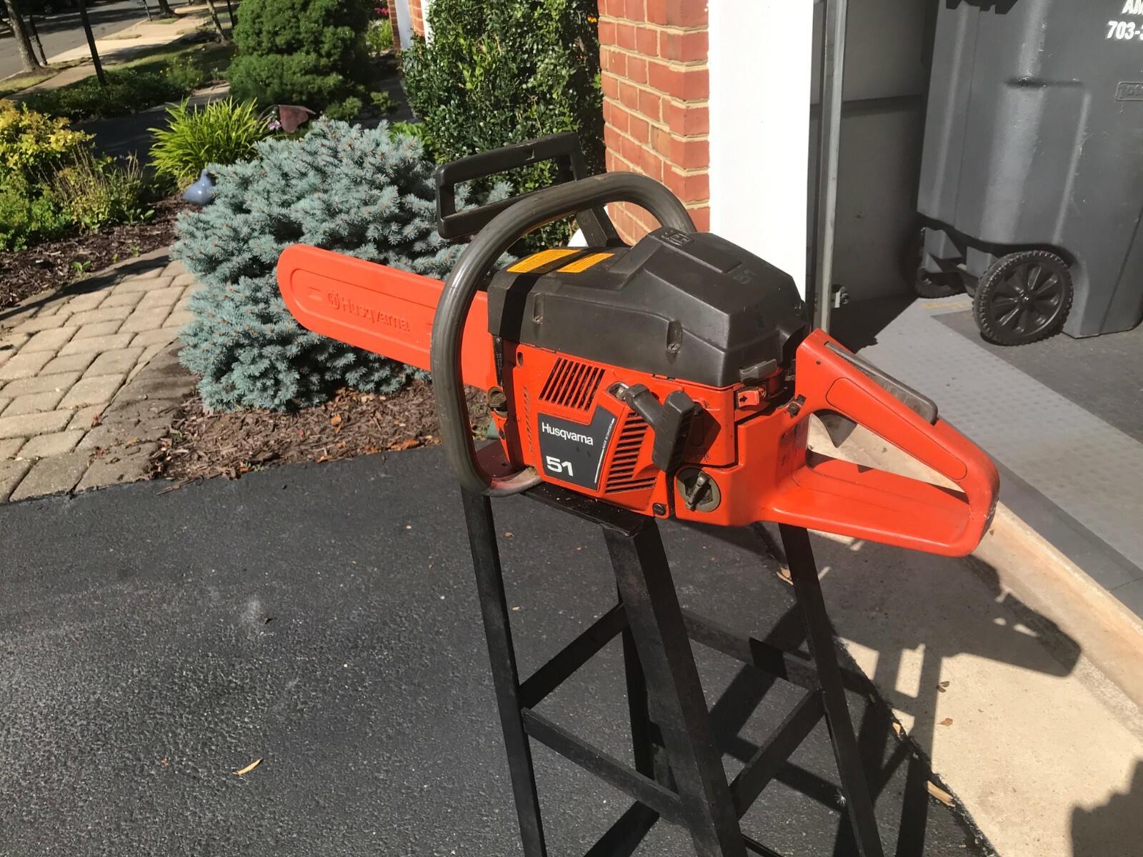

I'm going to try porting a Husqvarna 51 and I think I've read that the Zama was the largest carb that came on these saws, but I'm not sure. I just bought it on ebay so I don't know what carb is on it. Below is a pic of it.

im not sure how far down the rabbit hole ya wanna go...i think options are fairly limited if you want to keep an air filter, not much gonna fit under that cover.

nice lookin saw tho ronie, i really like the look of the grey top saws and that one looks real clean

Thanks, I thought it would be a good match for my 61 with a 670 top end and 630 cover. They guy said It's had very little use and he hasn't used it in a couple of years.

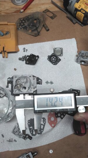

I put a ported closed port 55 cylinder on that saw and bored out the original carb, it was plenty of carb for it.

Did you modify the hole in the bulkhead? It is quite small too and matches original carb outlet size.

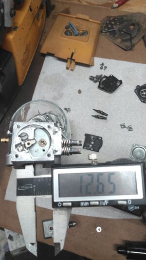

I looked to see if I took some pics of the carb but didn't. I did find a couple of pics of my Partner 500 carb that I bored out. I think it's a WT170

No, I only opened up the venturi.

Just measured. Bulkhead is 15.7mm and for example el32 outlet is 17.7mm. Unfortunately there is hardly enough material for drilling bulkhead hole any bigger.
