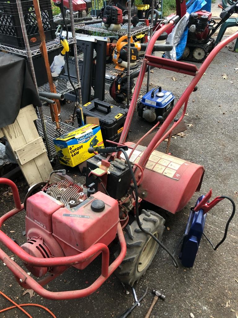

Anyone know how to remove the front cover on this kohler magnum 8? The tank and starter have to come off but there are no visible bolts/nuts to remove to do it? It runs good, electric start works. What’s an average worth?

Those TB Horse tillers will pull about about 800 around here in that condition.

If nobody helps you out before i get home ill look at mine and let you know.

Two bolts on the bottom tank bracket. Gonna have to flip it on its side or get under to see them.
