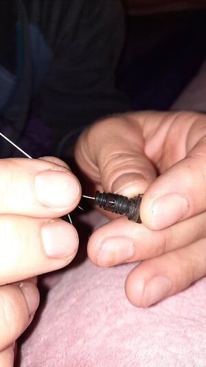

It poped off, it looked really clean. Altough different to what an idle jet looks like on a gx series, look here, timestamped
mine has no brass insert. And a really small hole, picture attached. I think I'll buy some spare idle jets and have the hole measured and if it's the same size, I will enlarge it a bit. I think it's worth a try.
Edit: I ordered carb cleaner, should come by post any day now. I will clean everything with it when I get it, maybe there is something in a hole that i can't see.
it's the correct jet, at least to this picture, size 45
What does the plastic screw sitting just above the idle jet even do? The hole doesn't seem to be leading anywhere. Attached is the picture of which screw I'm talking about.

The plastic screw retains the jet and also serves to set the idle on some models. In your case the servo motor set the idle so more than likely only used to retain the jet.

Just noticed to the left of the idle jet is a idle mixture screw. Appears to be set on the lean stop. If you turn counter clockwise you should be able to richen the idle. There are stops to limit how much it can be turned.

I see what you mean, it really is on the lean side, the butterfly can close completely. I have a good feeling that the thing will work with a bit of tunning. Ofcours if the servos find their way to reset to a known position zero :)
