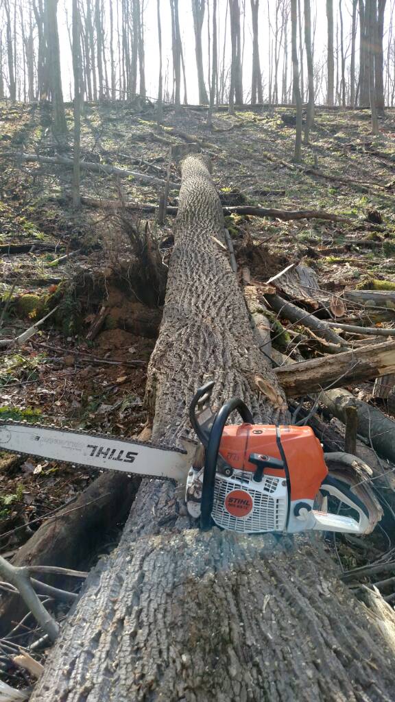

I've got 2 661s we use for logging. Mine gets the most run time. Ran it out of fuel yesterday so I walked over to my gas and oil and fueled the saw up. Clicked it down onto cold start like I always do and when I pulled it to start it made and awful pop kinda backfire noise. Wouldn't start. I held the trigger in and pulled it till it started and all was well for about 10 minutes. Then it started breaking up in the cut and won't come down off high idle. Tried recalibrating it but that didn't help either. This is my second 661, my first was a complete lemon that they never could figure out what was wrong with it. They replaced that saw with a brand new one thankfully. This one probably has 5 or 6 months on it. Ran 5 days a week about 2 gallons a day. Anyone got any ideas what could be wrong with it?
