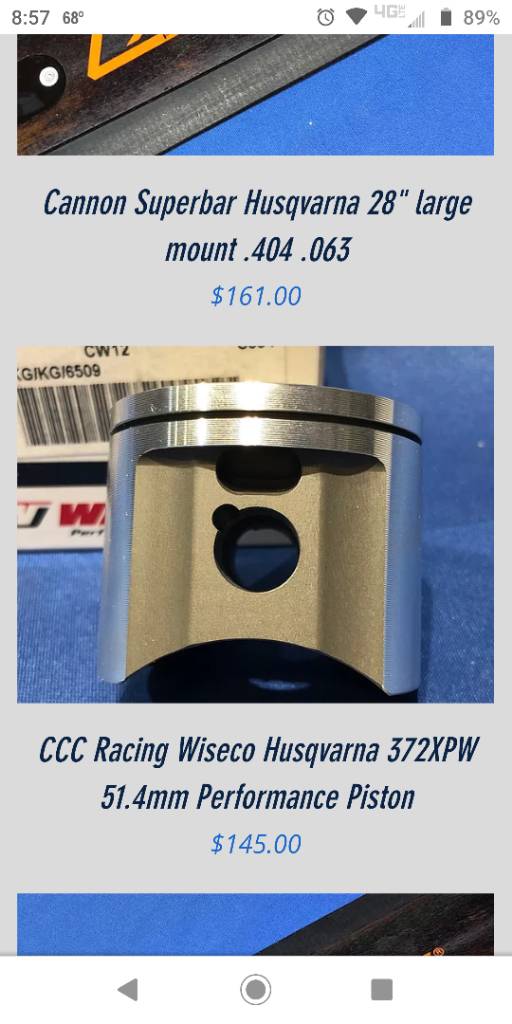

Trying to find one of these, got a cylinder in great condition but hard time finding a decent make piston, like to use this one on my next build.

Trouble is I live in Canada and by the time it gets here it would be about 200$ with exchange rate and shipping.- not to worried, I can just shelf that one I have until I locate a piston, Had one before and found there was no big power gains unless work was done on the cylinder- just finished up a 372 ported cylinder saw and have been cutting firewood with it the last couple of days, performance- wow, my 390 is also ported and for larger douglas fir - great combo.

Guess what I found on my shelf of pistons yesterday looking for something else, thought I had one from a guy that was going to rebuild his and never got around to it, OEM rings and all, will be running today, if I have time to finish it.
