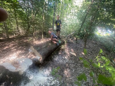

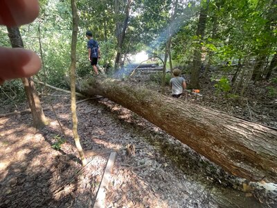

Yeah I've had alot of fun with mine also. I have 2 that are set up different just because there's a bunch of combinations that I wanted to try.
