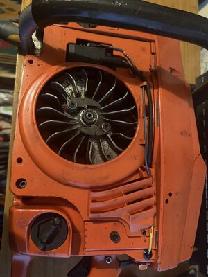

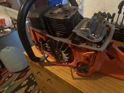

Hello guys. Today i making adjust timing on my 3120xp. Make w/o degree wheel (can’t have this tool) and take ~ 7-8 degrees. It,s ok for non ported cylinder or too much?
From improvements - muffler mod 3 port.
