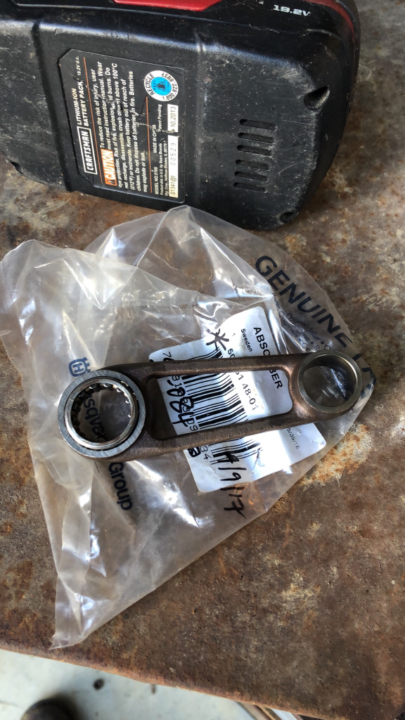

You can stroke the 084 /088 the problem is in the balancing.and Al Smith cliff is still building saws and so far they are the saws to beat I'm building a 088 and 090 160 cc saws right now
I’ve got this and an 084, I’m tryin not to lose to them 3140’s. How much can you stroke an 84?

You put that on and it will be alot more cc than 140

Your looking around 600.00 your better to leave it stock stroke if you're going to put a 090 on top of it

In any of the 3120 strokers or big bores they pretty much only use the 084 rod I had some costom hot rods made to, to do it
Interesting. I’ve been trying to track down info on that. I heard that Cliff and Ed started using something different than 084. That’s why Ed sold off most all of his rods. But I’m on the fringe so it’s all been hearsay.
