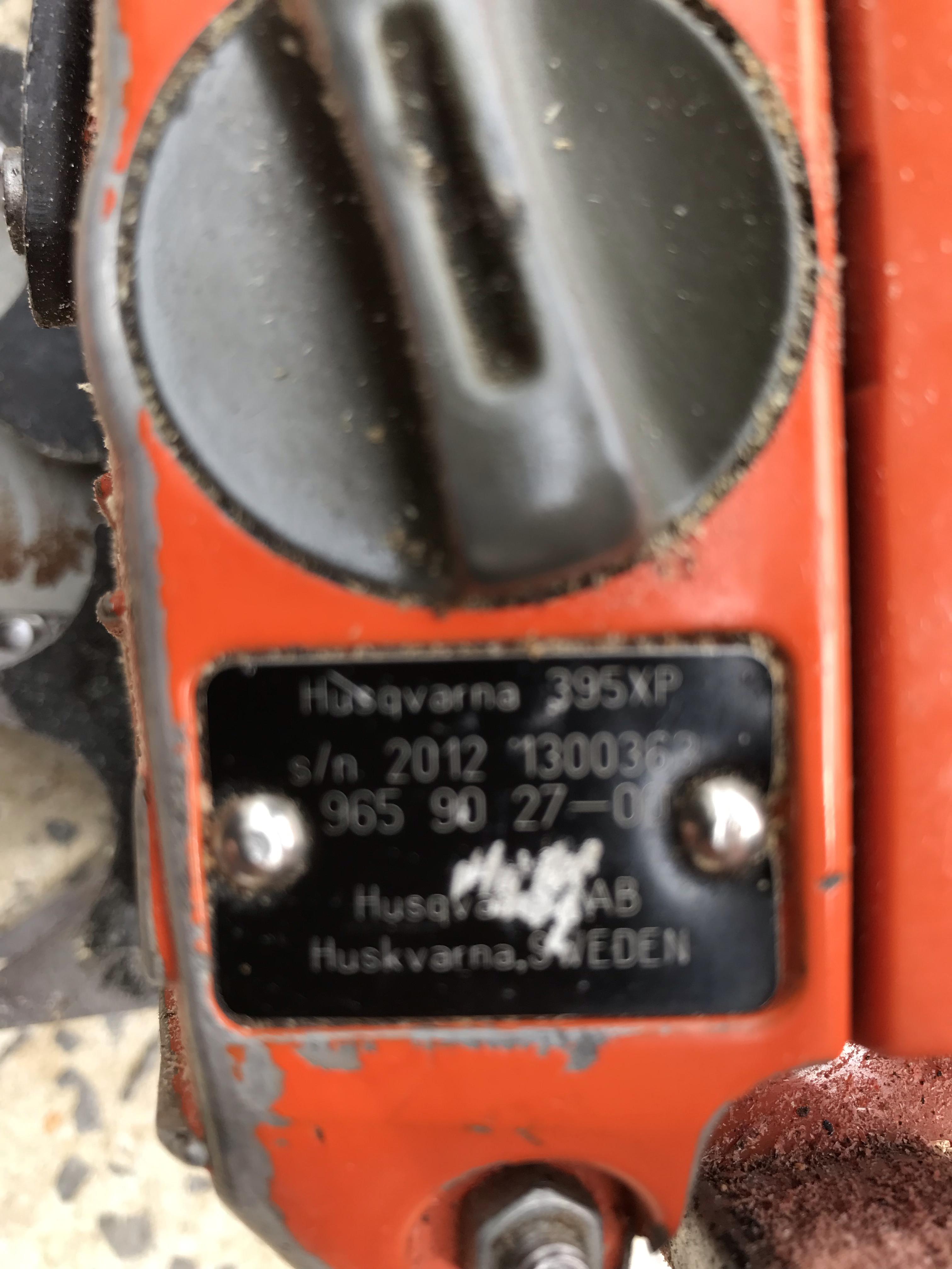

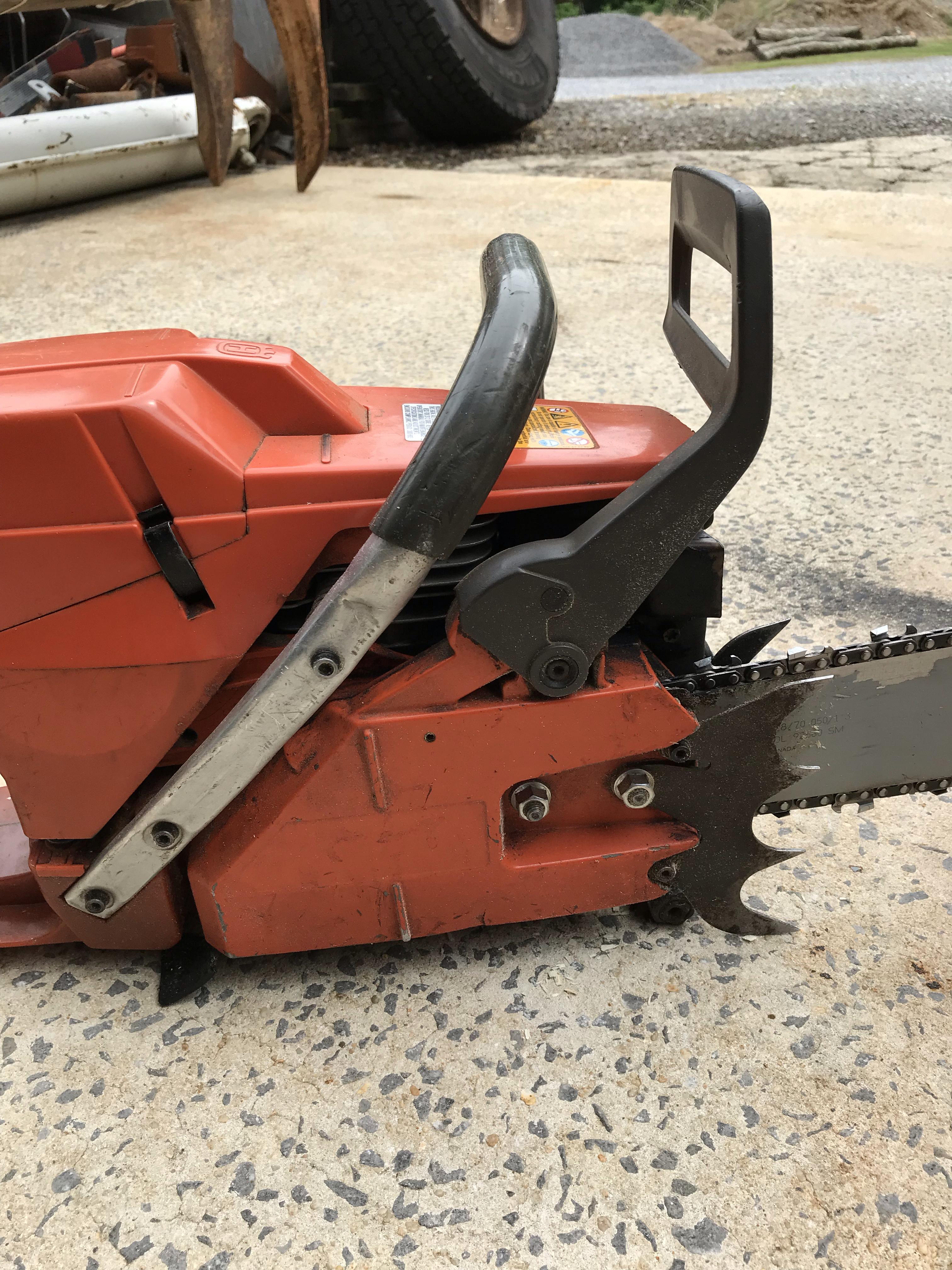

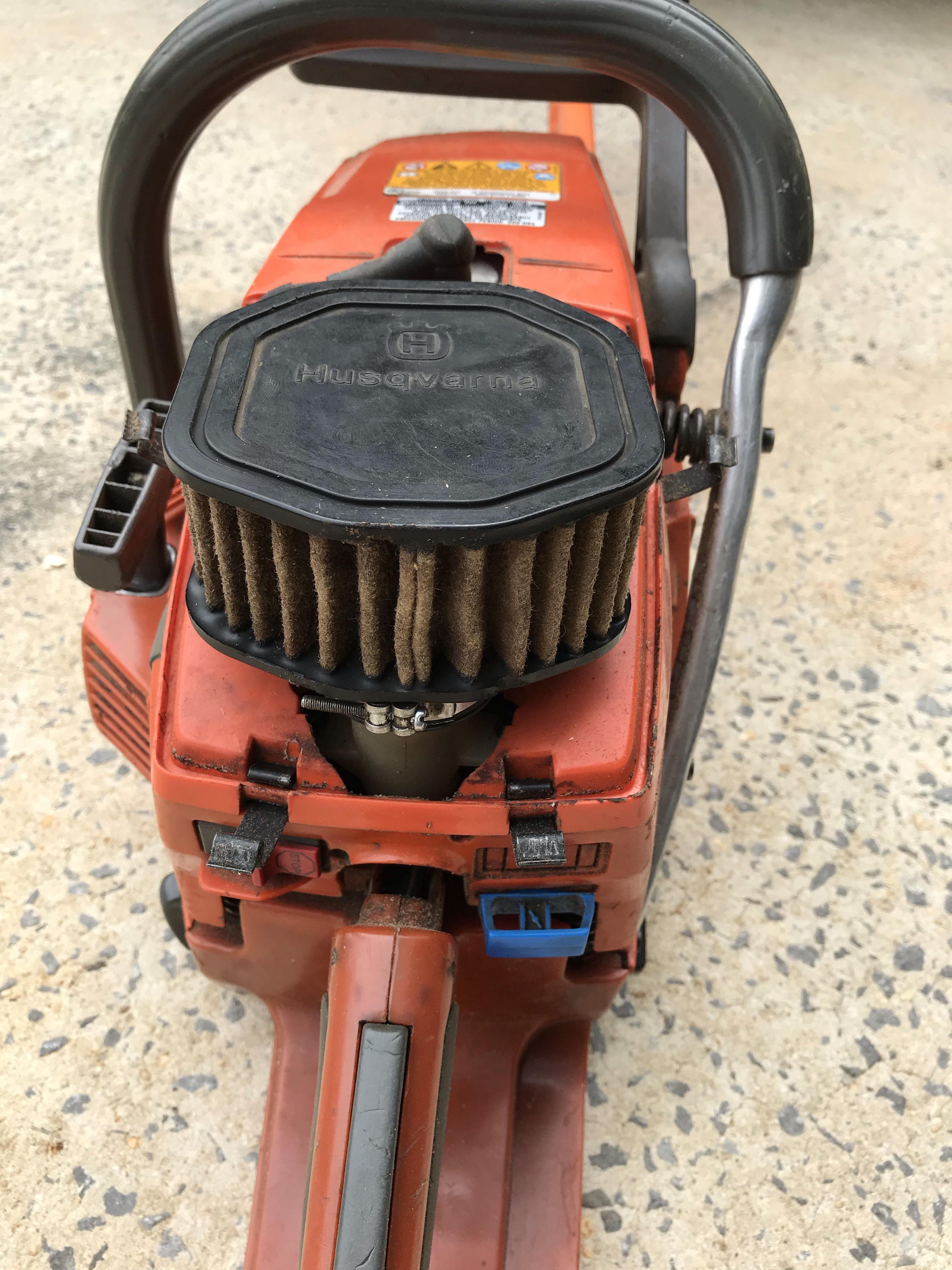

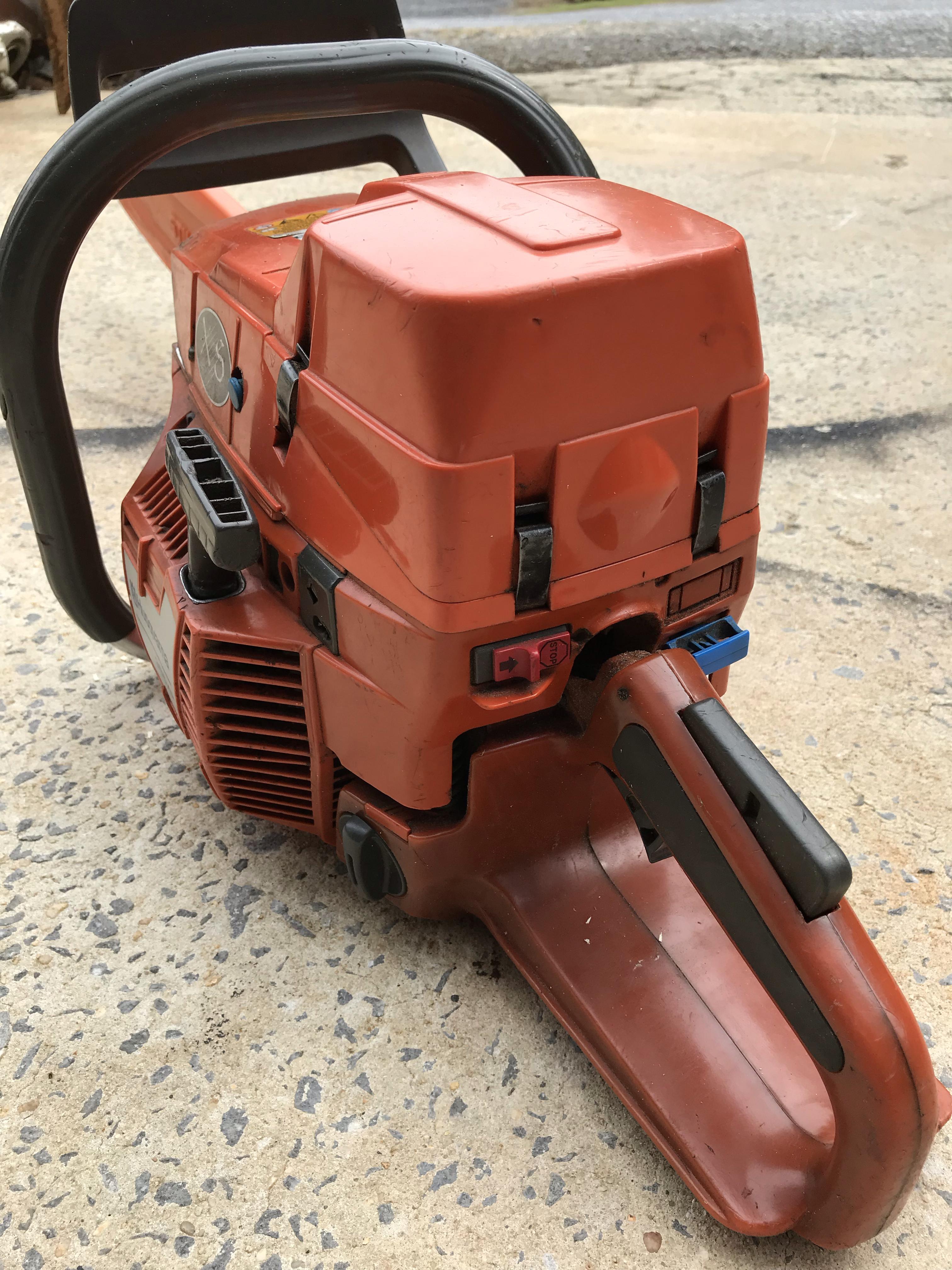

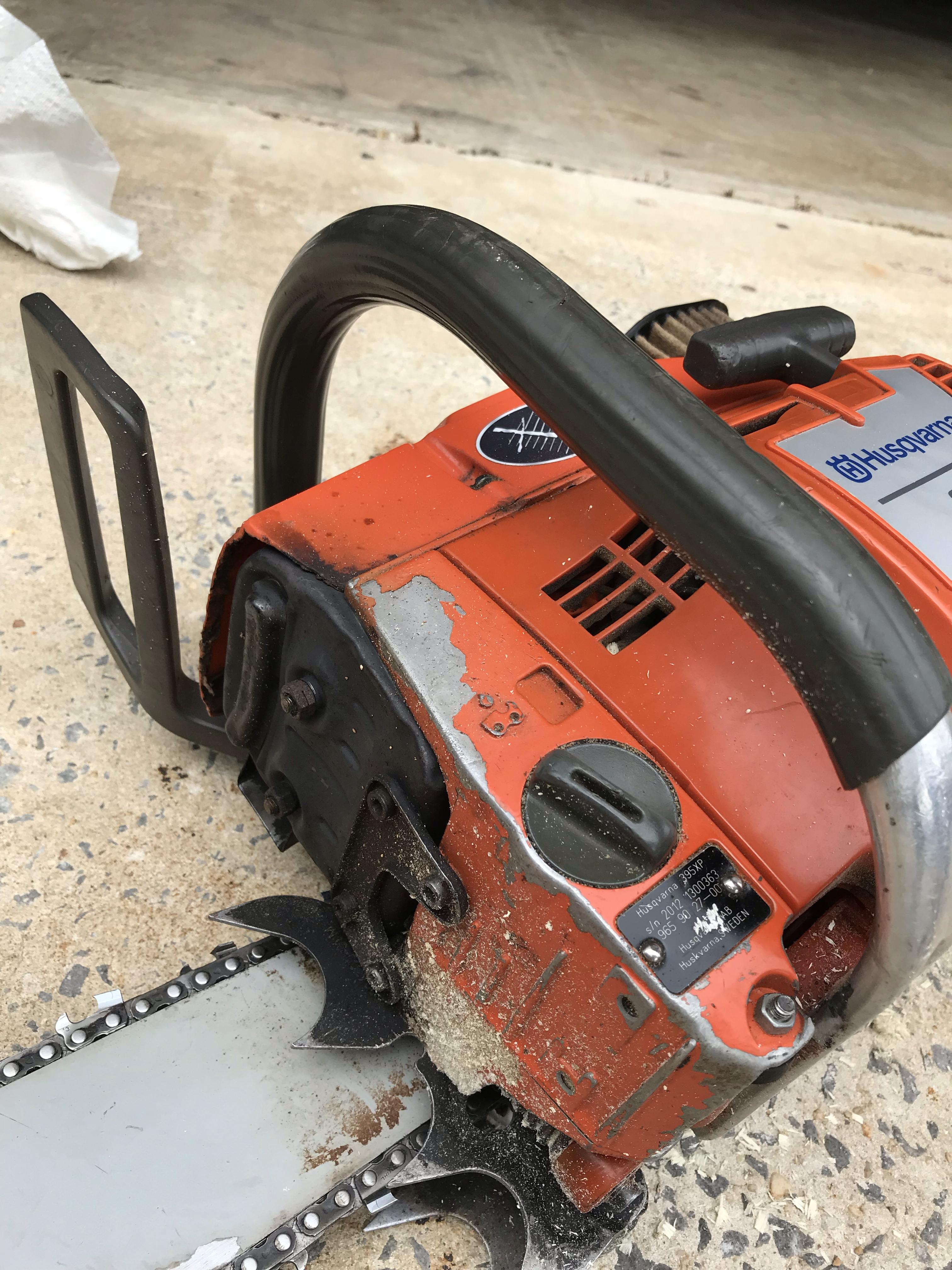

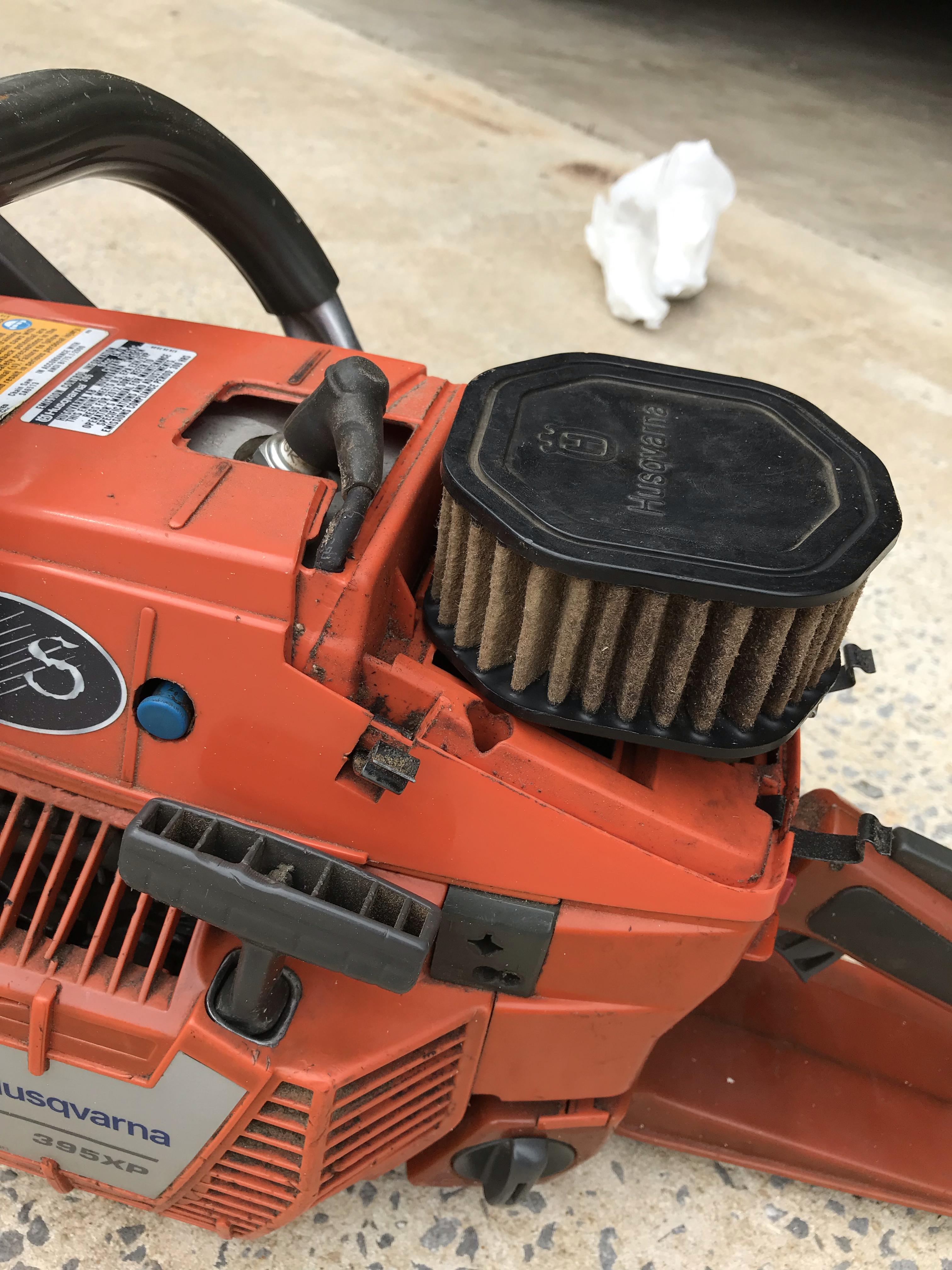

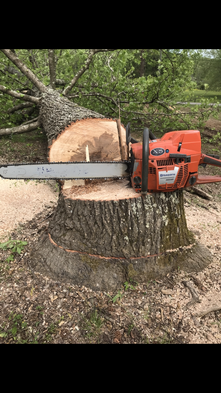

XS ported 395 strong running saw, everything works as it should. $700.00 plus shipping

I got this saw from Dustin, he shipped it to Kevin for porting.I’ve ran it a pretty good bit and now ready get rid of it.
I’ll entertain trades on other ported saws 50-60-70cc stuff.

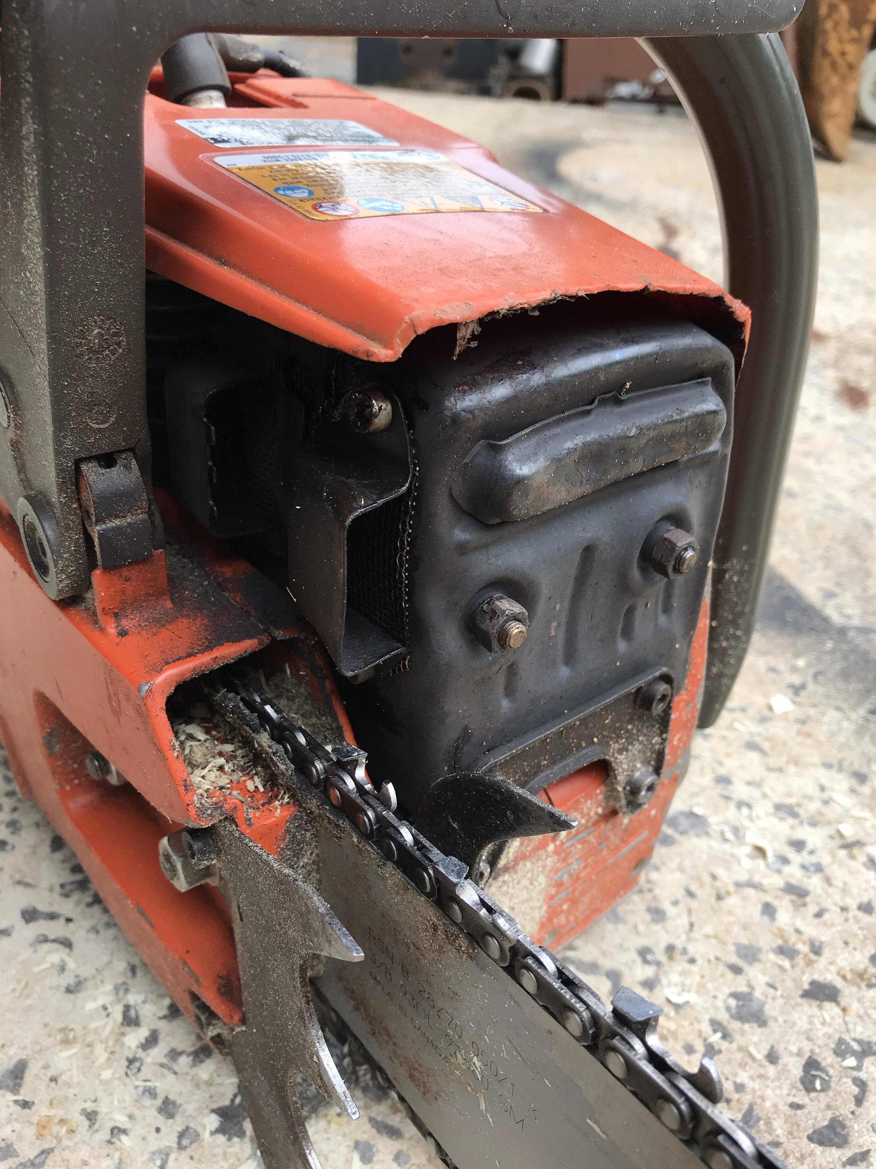

I don’t have the pics of the porting still. My recipe on this one would be:
.050 removed from the band,
Cut the base to get squish to .022”
Timed at E100 PT118 ST122 I78 ish
6-8* timing advance
And a 2nd exhaust deflector added in front of the stock deflector
Same recipe and time frame as this saw. 60” .404. Not gonna wow anyone with excess rpm’s, but it’ll pull a freight train if the chain is big enough

What do they end up at in terms of comp with 50 out of the band?

I'm waiting to hear back about it. The sausage update was my question. For me the compression needs to be minimal on the mill. Long bar mill saw is the goal when not using the 120cc saws. Wanting to compare one to this 394.
