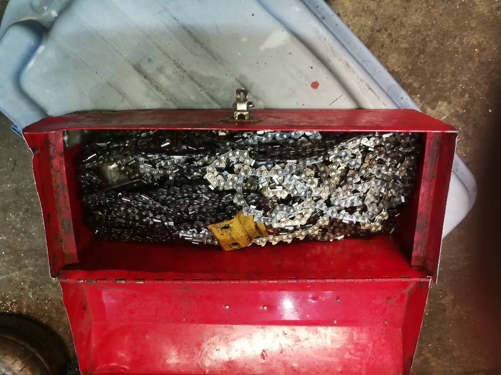

Harvester stuff is rediculiously cheap for sure... Had a guy give me this a while back. Some day I will build a saw with enough stones to pull it.
Mix of Oregon and Stihl, mostly new. If you were closer I would pass it on.
Hey thanks for the offer,
This new chamfer chisel Oregon .080 harvester chain looks like really nice stuff. High depth gauges and cutters, heavy duty chassis rated for min.25hp/ max.65hp.
I heard alot of problems with the expensive Stihl 46RST high tooth Timbersports chain with its low depth gauges and stretching problems.
This 19HX has potential as a good solid race chain with a little work.
