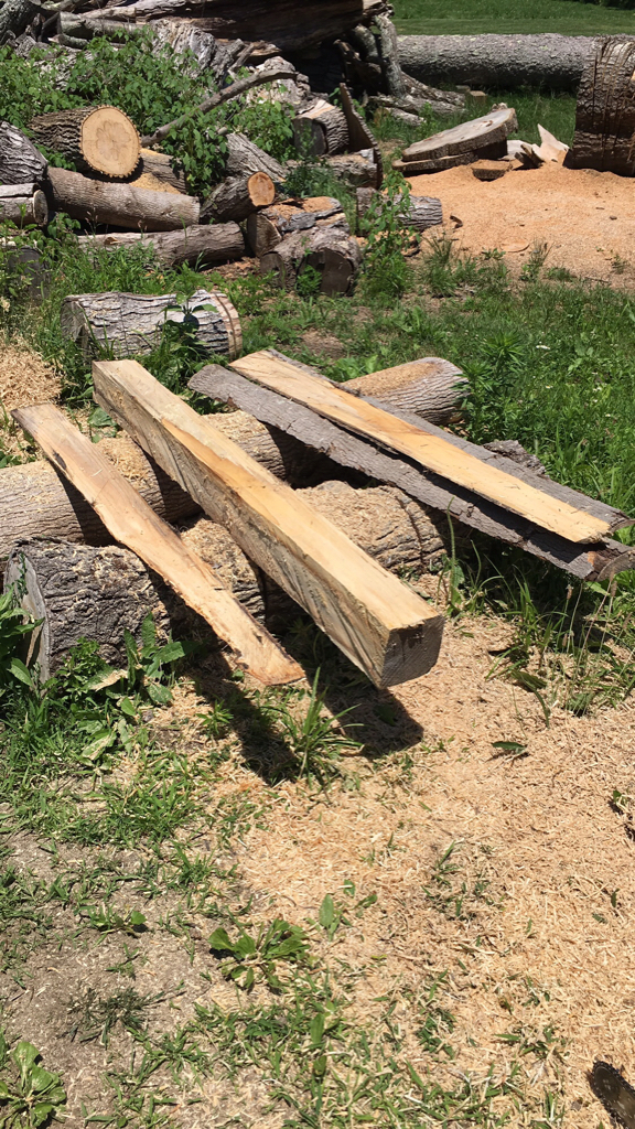

I didn't video but I just did this freehand with no lines with an ms 260.
Cutting this way it doesn't seem you need a very big Saw. A longer bar would be nice though.

It's not bad. A little practicing and im sure you can be reasonably accurate. You should try it Dave.

I have to say dan you did a great job. Thank you for the video. I'll have to try that out to make me some pine cants
Thanks Dave. And @Hammered is right. Cutting with the tip is way better than the whole bar. I've done it that way with a jig.
But it's going to take some practice.

Just took a swipe down a chunk of red cedar. I had it too high.
Video loading
I've got a 19'x24" pine here to mill up. I think I'll try the 460 with the 36" for reach, and if I don't like it I can grab one of the 394's
I'll have to try when I get a log. I've got a poplar and a very large red oak I need to put on the ground sometime.

Thanks for the tips!
I have a Makita 3-1/4 " planer and a 6" disk grinder, so I have a good start!
Now if I can get to where my initial cut looks like yours...
