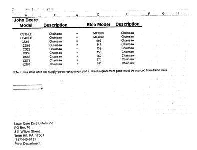

According to the IPL the part number you are looking for is PS10188 for both saws. The picture only shows a short length of hose, so hopefully you just need some bulk fuel line of the correct size. You will need to take it apart, measure and see what you have.

As mentioned they are Efco saws.
The CS62 is a Efco 962 and the CS71 is a Efco 971. Here are the IPL's
