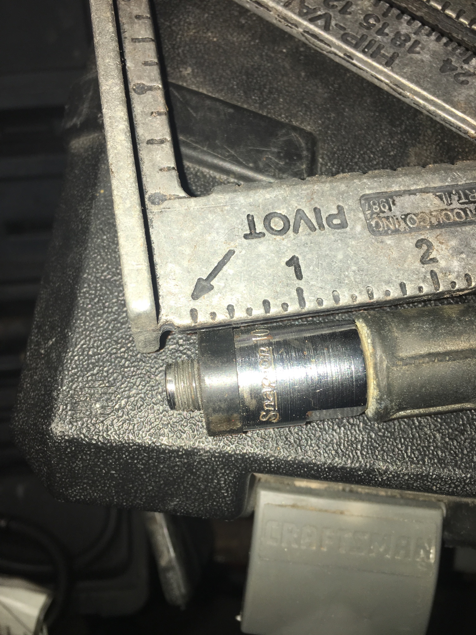

From the Snap on website
Description
• Long reach (M10 x 1.0 pitch)
• Thread length .70"
I think I bought the medium and you have the short I am going to measure in SAE and see this one is .70

Looks like the long reach is too long .70in= 17.78000mm

How about the depth of the Schrader? I think I will buy a specific gauge from Stihl and see what happens.

.43 = 10.9 aprox
