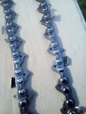

IMG_20230919_162725.jpgIMG_20230919_162731.jpgIMG_20230919_162834.jpgThe pictures are best I can get right now using my tablet. Cheap camera on it. I agree it'll probably cut slower, has a grit finish.Ill try to get logged it on my phone tomorrow for a better picture of the cutters. I think it looks pretty much like you'd expect. Kind of stove up right now. Had to move some of that pecan out to the property. Nothing like doing it the hard way, but its done except for chunk. Might be the weekend before I get to try it in that oak, I have the first 8' and the 2nd 8' up. Think ill go high and hope to save the nails for last. Guaranteed to have my own opinion of it by then.

The top of the "coated" cutters should look and feel similar to anything diamond coated.
I am curious to see better pictures of that loop.
You do not want to use a carbide TIPPED chain if You KNOW You will encounter foreign objects in the wood You are cutting.
Chipped carbide tipped cutters are duller than a regular dull steel cutter, and grinding carbide cutters in hopes to revive them is more tedious too.

I have a couple of loops of that type chain from many yrs back. It has carbide grit on the top and rolling slightly on the outside of the tooth. Sharpens with a file or grinder fine. Does stay sharper for quite a bit longer than regular. That was Carlton, NLA. Several yrs ago I wanted a few different lengths for other saws and all I could find was Oregon Diamonized, ( made the same way) not near as good as the Carlton for keeping the grit on the tooth until worn out. These were both semi chisel.
