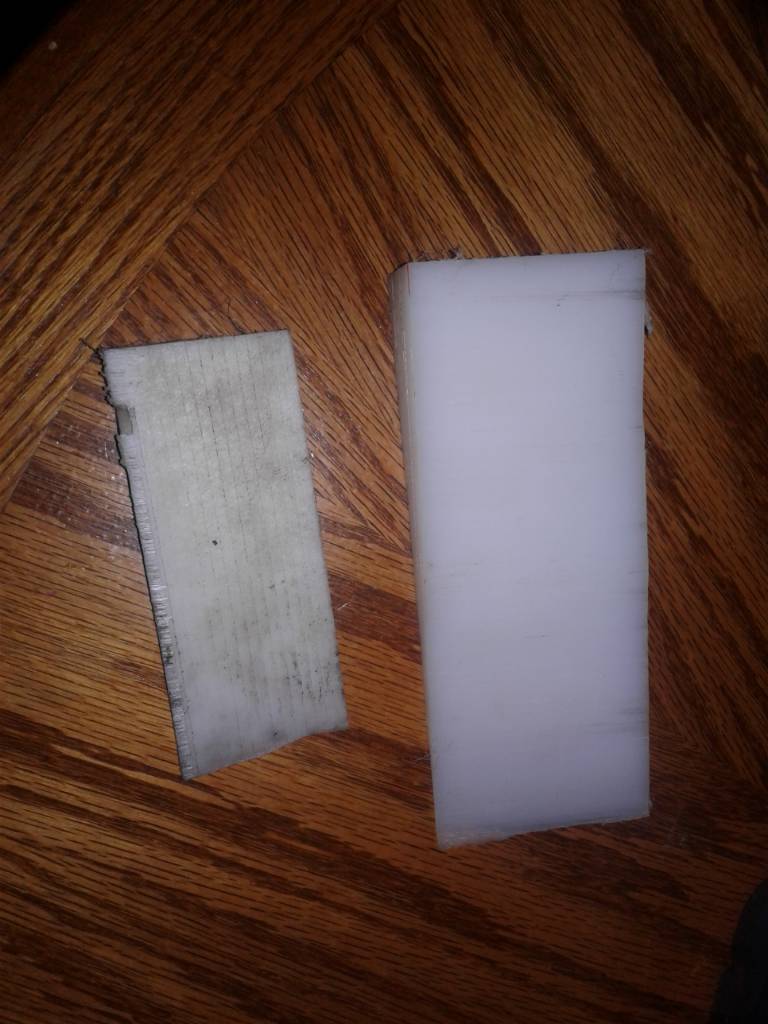

I used to buy wedges and fix them also when they broke or hit them with saw.
Now i use this plastic material that i found at work. Once in a while they throw out a small chunk and i have permission to take scrap from the bin.
I cut them on the band saw to shape them. (Yes on company time [emoji3]) just have to go slow or they will start to melt as mentioned above.
The smaller one in pic is handy for keeping in back pocket for bucking.
I yet to have one of these break and i smash them pretty hard to test them out. If i happen to nick the end with saw i also use the belt sander. Mine is variable speed and on low it dont seem to melt too bad.
In my experience the worst wedges i have had are the hard head ones with the metal plate. They broke way to easy.
