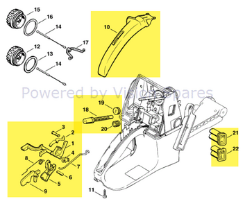

I think this is it. Thank you
1.) 1122 182 0902 - Stihl Switch shaft
2.) 1130 442 1602 - Stihl Contact spring
3.) 1122 442 2500 - Stihl Axle
4.) 1122 182 2100 - Stihl Support
5.) 1122 180 1500 - Stihl Throttle trigger
6.) 9371 470 2600 - Stihl Cylindrical pin (DIN7) - 5m6x16
7.) 1122 182 1502 - Stihl Throttle rod
8.) 1117 182 4500 - Stihl Hook on spring
9.) 1117 182 0805 - Stihl Lever
10.) 1122 791 0600 - Stihl Handle moulding
18.) 1127 141 8600 - Stihl Impulse hose
19.) 0000 989 0812 - Stihl Grommet
20.) 1122 182 0700 - Stihl Grommet
21.) 1122 123 7504 -Stihl Grommet
22.) 1122 123 7503 - Stihl Grommet

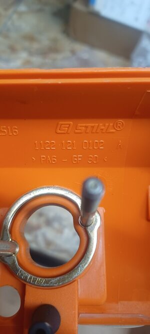

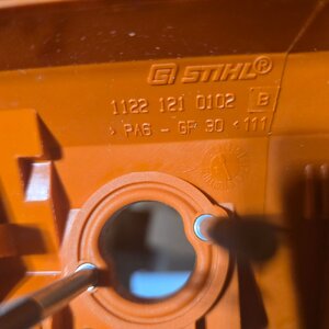

I'm not by it at the moment, but here is the image from the ebay listing.
Man, that is weird it has no pressed in axle. I don’t think I even bothered removing those from the junk tanks I had.
What is the pt# on the orange top? Will see if it matches mine.
At least they included a vent 🙄
I'll have a # when I get home in 3 or 4 hours. I can't make it out in the picture I have from eBay.

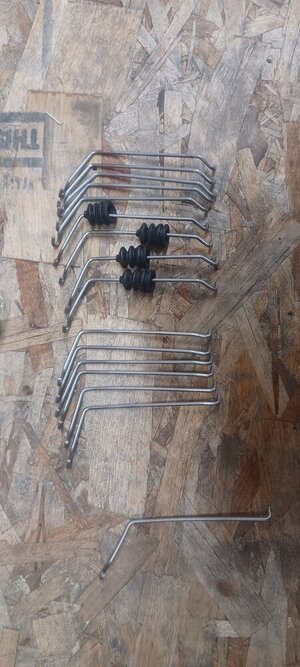

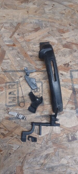

So, have most of this. But, found a bunch of different throttle rods, hmm.
Top group is like what I used on my early 066 FT. Bottom may be for early 064s.

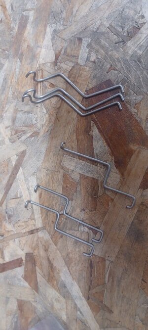

And, another bag with 3 more designs...

So, @jacob j. ...any ideas on all the different throttle rods? I know the early 064s with Bing 49s used a different rod than the later 066s but that's about all I know on that.

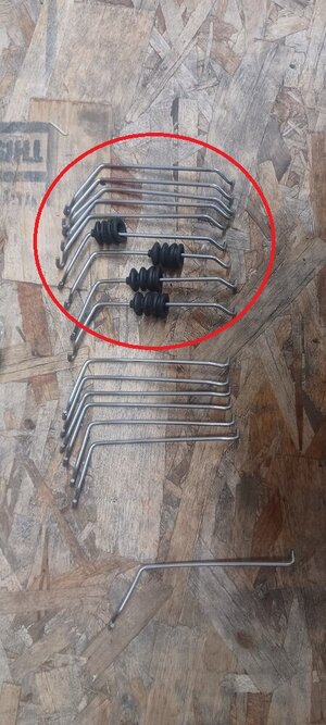

I've circled the later style throttle rods in your picture that would be compatible with 660.... the throttle rods not circled are the older style that came on the 064s with the non-clear tanks.
